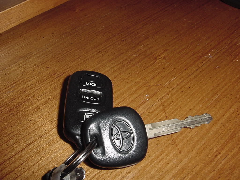

Do 3rd gen. 4runners have to give up a key if they wanted a remote starter? My runner has the security system that came with the car from the factory, so i think all i want is the remote starter.......know where i can buy one? And can i install it myself?
No you don't. I didn't in my 98 and I believe we have the exact same security system. But, either way I have never heard that toyotas have transmitters in their keys.
I think some of the late 3rd gen's had it (maybe 2001 and 2002 and possibly 2000). The keys for the ones that have the transmitter are very fat plastic at the top. All '03 and up 4Runners have the transmitter imbedded in the keys.
Heres a pic of my 1999 4runner's key and security device, does it have the transmitter?

Does that mean that the key does have a transmitter? If it does, then i dont think i want the remote starter because im actually losing a safety feature. But if i dont have it to begin with, then id feel fine installing one.
