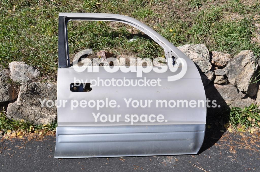

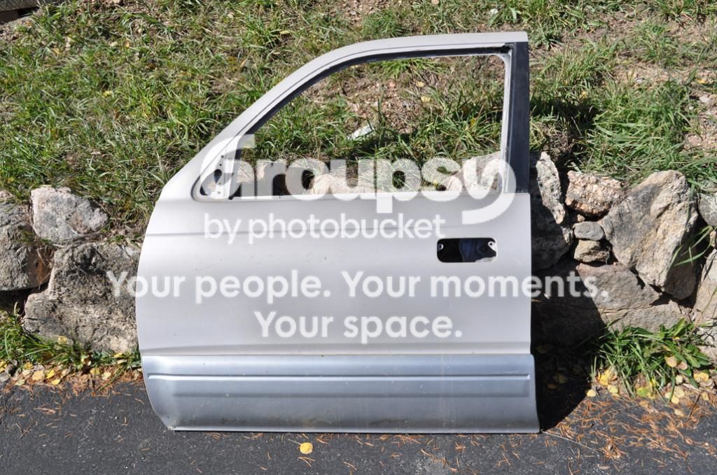

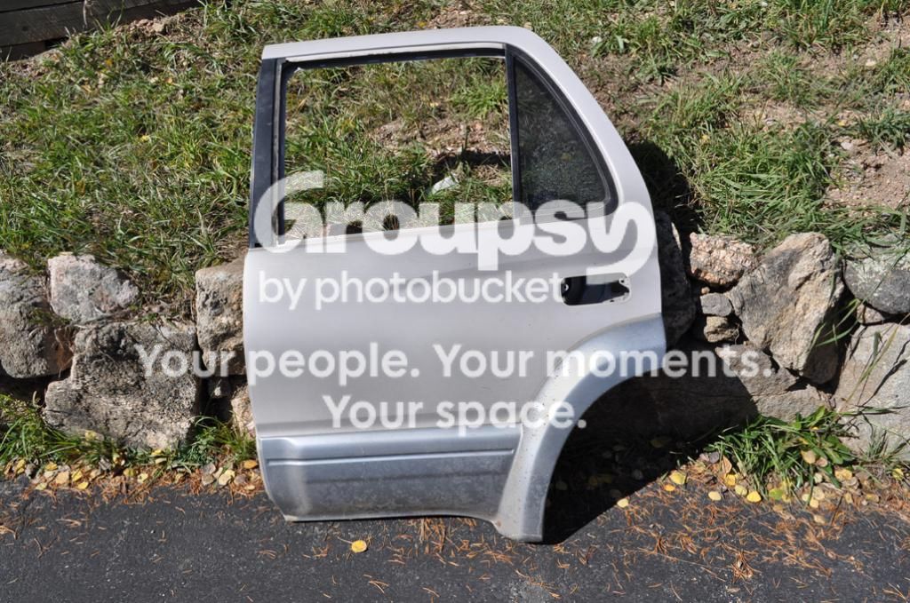

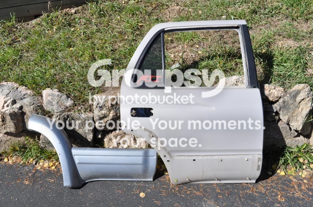

Since the OP had his question answered, I'm doing a little hijack here, if anyone in Colorado is looking for some door shells to make half doors, pm me. These are the shells only. Couple dents on the passenger front door, but other than that, they are in good pretty good shape.
