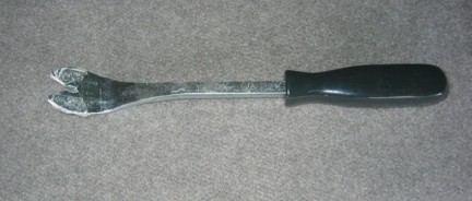

get a panel removal tool. I picked this up at walmart or pep boys or something for 3 or 4 bucks. tape the tip with tape just in case.
After the screw in the armrest cushion and behind the door open handle, slide the removal tool around the outer edge. There are about 10 places that will pop out. You shouldn't ruin or have to replace any of the tabs. They come off pretty easy. go slow, identify the tabs, and straddle them with the tool and it will be no problem.
after all the tabs, there are two cables, and something like 3 electrical plugs. I'm going from memory. There are a few good posts here that go into details. Post if you need more pictures (my PM doesn't work). I've removed almost all the interior panels in the truck, and the doors are the easiest, so don't worry.
even first time around, you can probably have each panel off in 30 minutes. however, the speakers, because they are integrated in the housing and unusual size, replacing them will take longer. With me, i had the panels off the doors for several days while working on the speakers. be prepared for that.

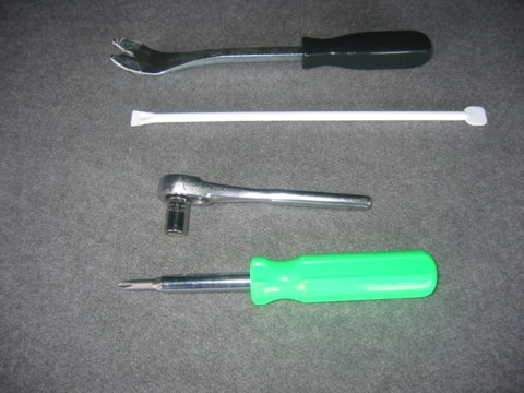

also, get a stiff plastic screwdriver type tool to use to pop out small plastic pieces such as the one behind the door open handle. (shown second from top in this pic). I got this from where i work and its perfect. again, peruse walmart and pep boys to find an equivalent. it will prevent scratches. Pretty much, with the tools shown below, you can take apart the entire interior of your car.
