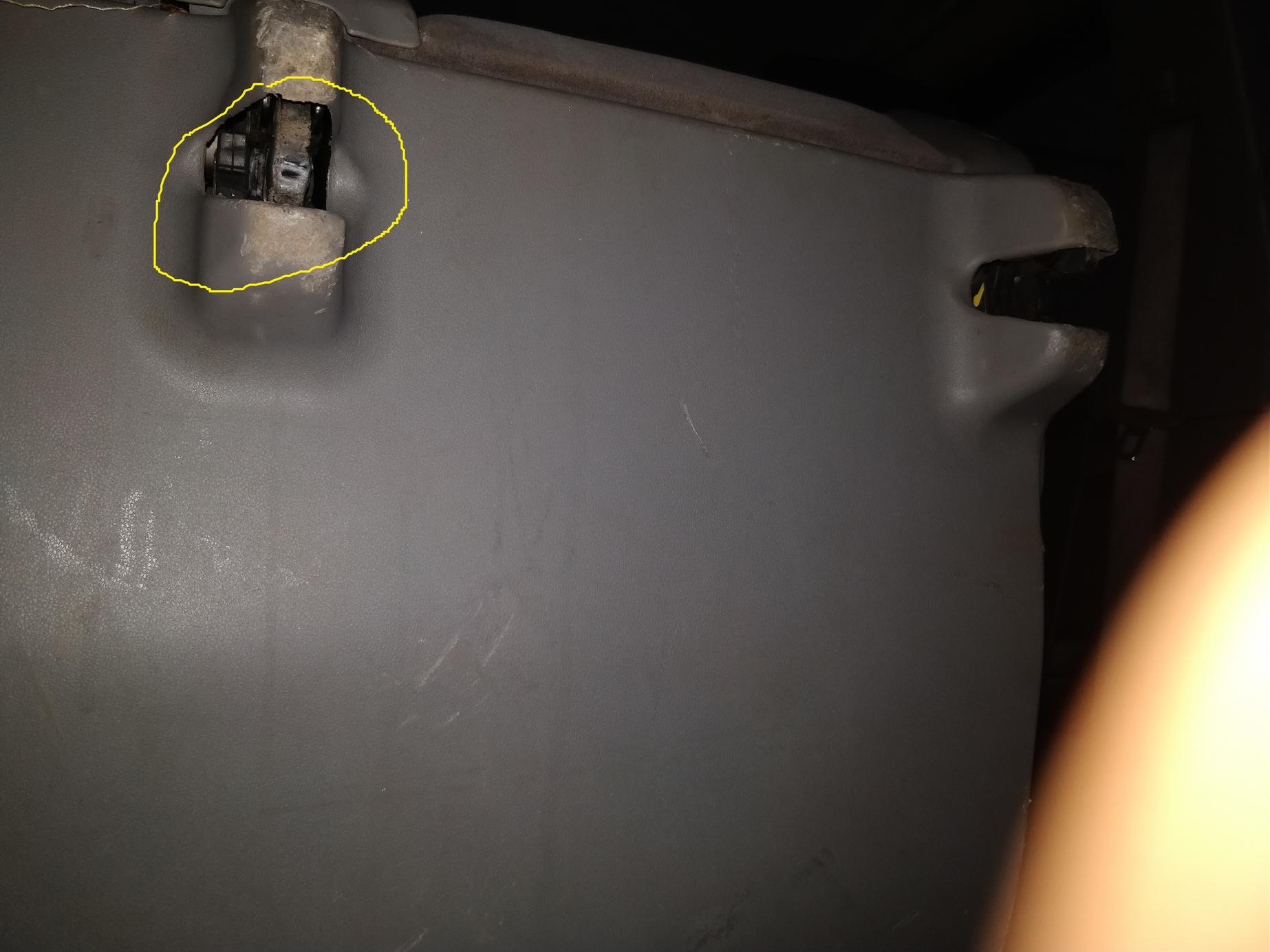

so removed my rear seats to clean my floor carpet, now i am about to install them and they will not sit properly, closer inspection shows one of the claws is in the locked posiion, attempts to pry it open with a screw driver failed, would appreciate any tips on how to resolve this
There should be a lever / handle / strap / pull-cord to button to unlock a seat correct? Yours does not have that?
A picture from the side (at an angle that would show the parts of the mechanism) would be better.
