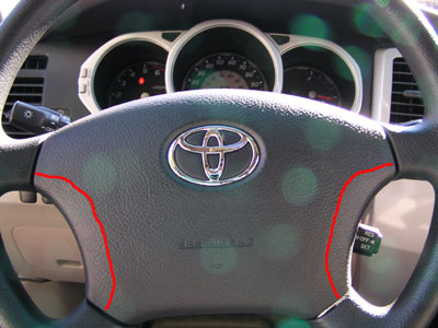

The airbag cover is different for both models, so you need the one for the one without the, that is if the airbag module isn't permanently attached to the cover. The airbag cover extends over the audio controls and plastic trim piece on the opposite side, so there isn't a plastic piece where the audio controls or the corresponding piece on the right side. You will most likely need to replace the airbag module. From the looks of it, you could keep the leather wrapping, but need the airbag module.

Here's a picture of the wheel without the controls to give you an idea of where the controls are supposed to be.

I just checked the factory repair manuals. The cover, airbag, and horn button assembly are a single component. The manual even warns against any attempt to remove the airbag from the cover. That being the case, the only way to downgrade will be get get (at least) a whole new cover. $$$$$$$!!!!!!!
