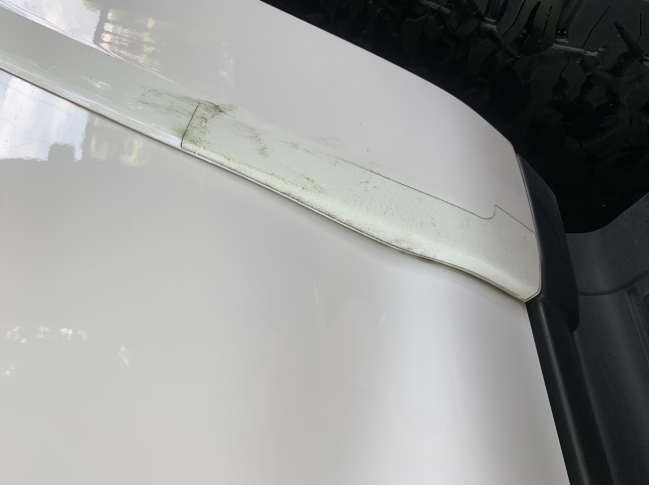

This is a nightmare. Currently using goo gone and a rag. Any one got a better suggestion ?

It's a miserable project that takes forever - and heat, pro-strength goo gone, and an old credit card to scrape the crap off. Never again.
Well... I’m done. Lots of scrubbing and goo gone.
Does goo gone damage the paint protection? Should I polish the area ?
DO NOT use Goo Gone.. you will scratch your paint.
Heat gun and lots of patience and take your time.
Congrats on your success! I would do a complete wash and wax like you usually do, and see how it looks from different angles.

These are not paper stickers so his recommendation does not help the OP at all. But if you want to smear peanut butter on your clear protectors let us know how that works out.
A few weeks ago my boss took on a job removing a clear bra and rocker protection on an 09 Maserati. Of course I got to do most of it. What a nightmare.... I took most of the actual plastic off with a pressure washer and MANY hours of time. Then contractors solvent and sharpened plastic pry tools to take off the adhesive. The remover wheels do work great but we were very nervous about messing up the paint and having to repaint half the car. Then another day of wet sanding and buffing the 11 year old metallic black paint to make it all match. Not something we'll ever take on again. And honestly if it hadn't been for one of his family members we would have never done it in the first place. I'm perfectly happy leaving it on the doors of my 4Runner...
