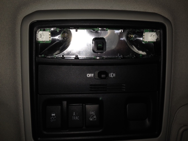

Is this how 2014 4R owners are changing out these bulbs? I am so frustrated right now. I have SR5 4x4 and these damn bulbs are stuck in good. I tried the electrical tape trick, no workie for me, tried pliers, something that should be so easy is wrecking my night.
How does this console detach from headliner?
super glue
You aren't trying to save the bulbs. Just superglue a stick to them and throw it away.

yeah after about 10+ mins I gave up and just shattered the bulb. pulled out just nicely after that, even then they were still hard to pull out with needle nose.
I got the left side out with needle nose after about 5 mins w/o shattering the bulb, but the right side I just said GTFOut.
