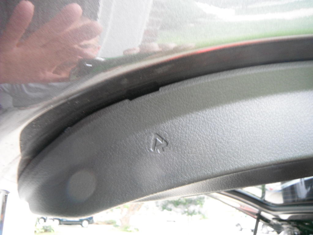

Will someone please tell me where to pry on the lens on the rear hatch? I am fearful of cracking the lens and/or breaking plastic clip. As you can see in picture, I had already goobered up the black plastic by prying with screwdriver..:(

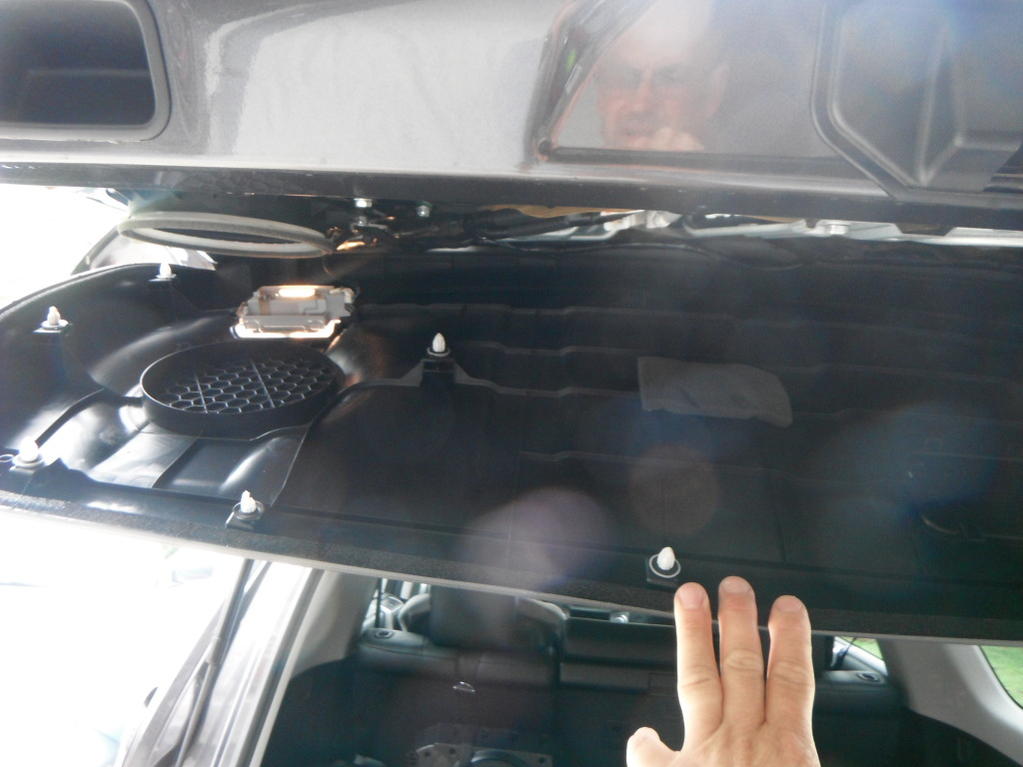

I find it easier to pull part of the rear panel down like this (pry at the slot in the plastic).
Then you can see the clip holding the light in place and release the electrical connection easily.

Haha pulling the whole panel is a little intense for me. On the 2014's, the rear hatch has a metal clip on the right side of each light that clips the whole assembly into the panel. Play around on the right side and get your flathead underneath the metal piece and pull out (from the right).
Pretty sure it's the same on the older ones too as I found some instructions in some old post.
It takes about 5 seconds to pull the panel loose, if that. But to each his own.

Mission accomplished. I used both your advice. I pried with screwdriver at designated place, unclipped like a charm, a little scary but better than marking up my plastic. The driver side was easy to do, unclipped from power supply and did not try to install the new LED inverted. On the passenger side (2014 has 2 lights in hatch) it was alittle more tricky as the pull handle gets in the way of just having open access like the driver side. I knew where and how to more push in than pry the little metal clip holding assembly in, popped out, disconnected from power and installed.

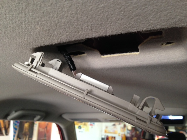

Maybe to help the next soul, here is a picture of the dome light. Notice the "hooks", their locations and know how they unclip from headliner.
