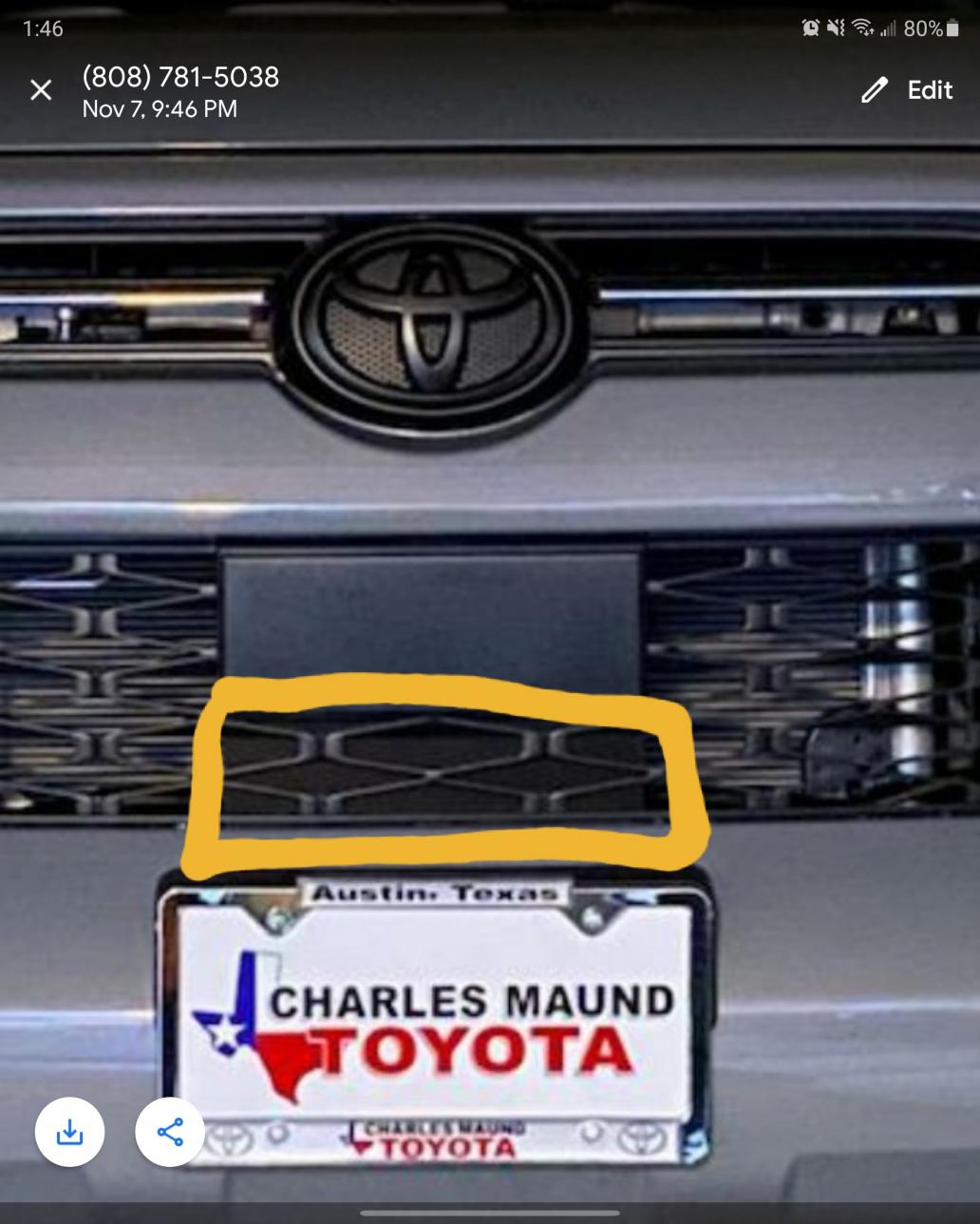

Just got a 21 trail edition and I want to put in a led bar behind bumper and know that cali raised allows for it. But question specifically is about the tss. The top half is the radar and the bottom half appears to just be plastic. Is the bottom part functional? Has anyone tried removed this bottom portion? I don't like the idea of the light bar living and being blocked out by some useless plastic.

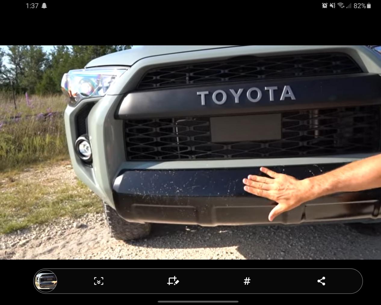

Attaching some pics for reference. Notice how the 2021 trd pro does not have the plastic underneath the sensor, which leads me to believe it can be removed.

It's not removable...it's part of the grill itself. I assume it's there to provide more rigidity and stability for the TSS sensor.

Yeah just confirmed it is molded in as part of the grill. That said there is nothing behind it... which makes me think it must be something structural.
Ehhhh, structure, who needs it?! Useless plastic <> meet Dremel!

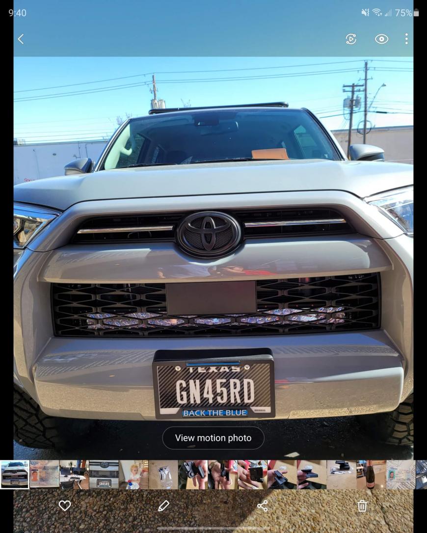

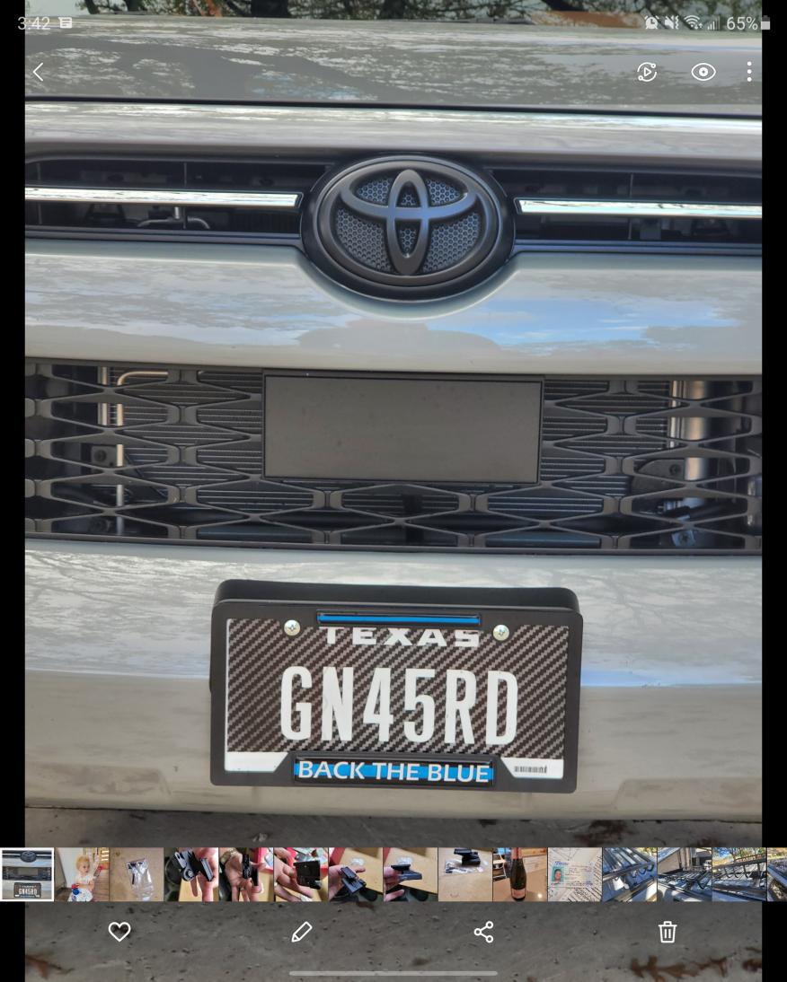

Success! Mostly...
I am not much of a craftsman and get a little trigger happy with electric tools... here was my process:
Used wireless dremel with the skinny drill bit cutting/engraving attachment and just went to town clearing out all the excess plastic below the TSS. From there used some files I had to make it as flush and cohesive as possible. Next used flat black touch up paint to paint over all sanded sections to match the color of the grill.
Up close and personal, you can see spots where I got a bit wayward with the dremel. But far and away it was a massive success. Can confirm nothing behind it and tss is snug as a bug. Really no clue why this plastic was there in the first place.
Light bar installed in a few days will post another pic.
Huge success. Great mod with a clean look!
