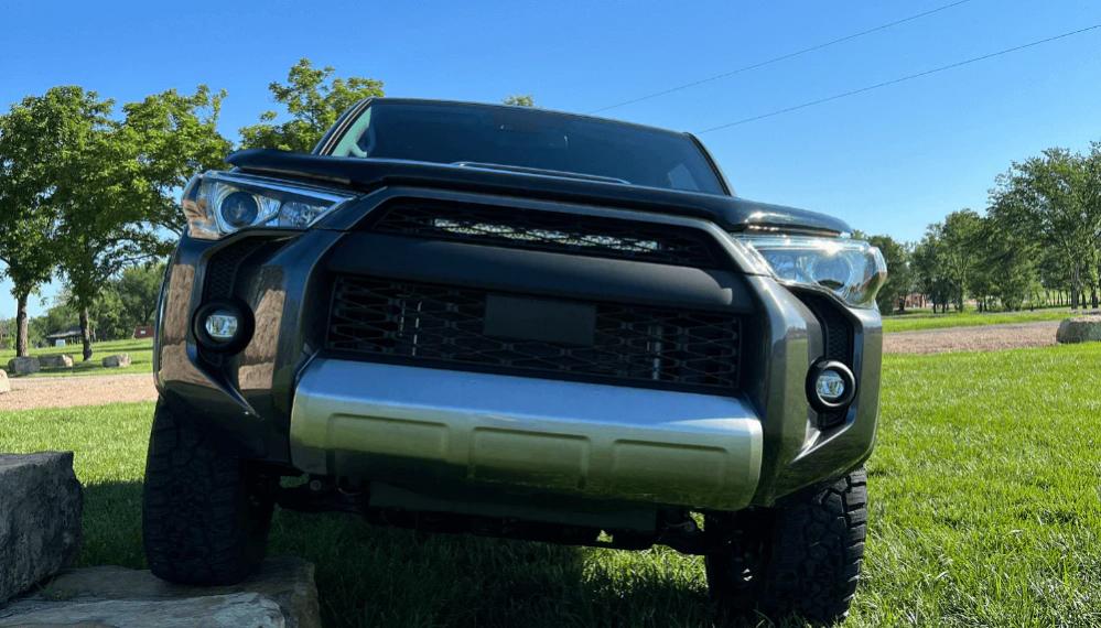

Installing a light bar is no easy feat, as each truck model poses its own unique challenges. However, if you're in need of a comprehensive installation guide, consider yourself fortunate. Lasfit customer Allen has generously provided us with this detailed installation guide and review. Wondering how the Lasfit amber light bar stacks up? Join Allen as he takes us through his installation process and provides his firsthand perspective on its performance.
**Disclaimer: This installation requires a TRD Pro Grille to be installed so the light bar can shine through the front of the grille correctly. This install is for 2020+ 4Runners with TRD Pro Grille. The TRD Pro Grille kit does not use the factory radiator mount.

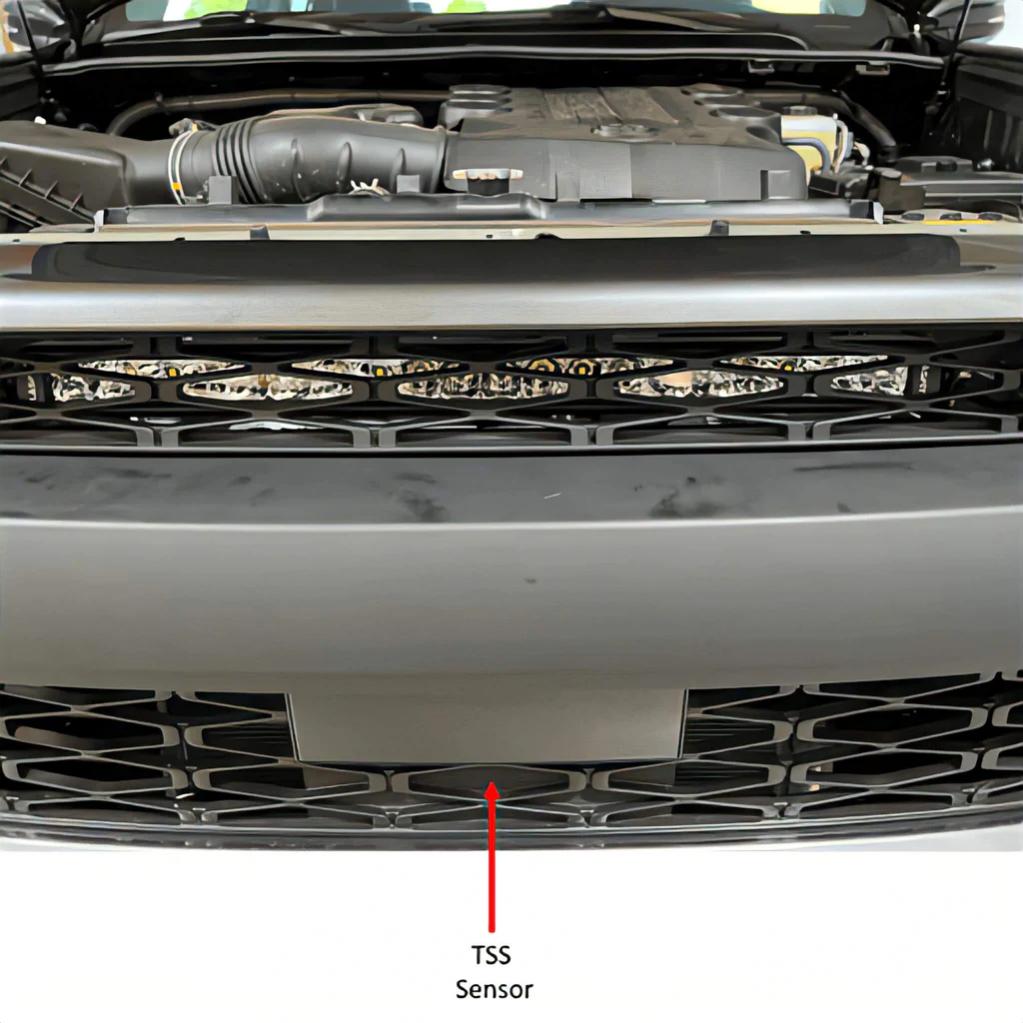

Due to the new TSS sensor in the lower grille potentially blocking off light from a longer light bar in the 2020+ 4Runners, the upper grille was a good choice to install a quality light bar. The Lasfit 22" Light Bar fits the bill perfectly!

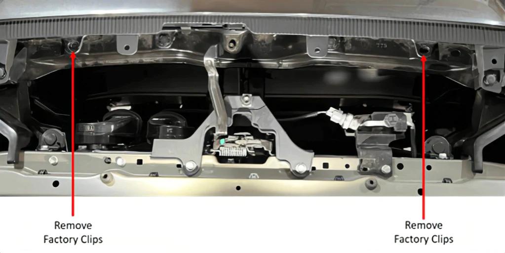

Step 2: Remove The Factory Clips.
Remove the (2) outer clips that connect the lower grille to the bumper. You will use these two locations to mount your light bar brackets too. (See pictures below)

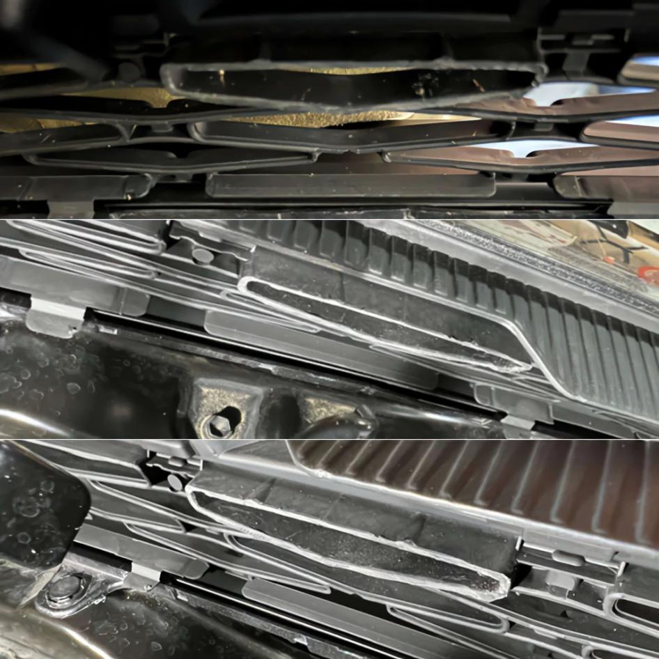

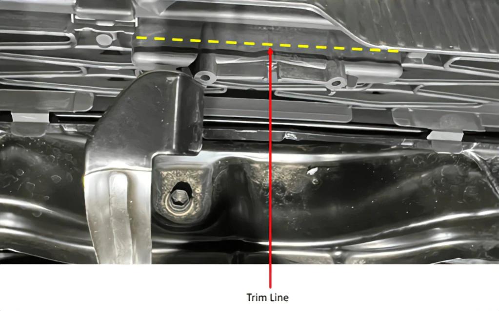

Step 3: Trim the TRD Pro Grille Factory Radiator Bracket Mounting Location.
Trim the TRD Pro Grille Factory Radiator Bracket mounting location. This is in the upper part of the grille on the backside. Since the 2020+ year models do not utilize the factory radiator mount with the TRD Pro Grille, you may want to trim this as not to block the light going through the front of the grille. Also, trimming this will allow the light bar to be mounted as close to the grille as possible, maximizing light output from the light bar. See trim pictures below:

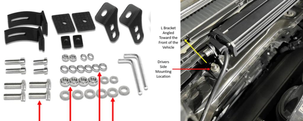

Add 90 Degree “L” brackets to the 22” Lasfit Light Bar loosely using the Lasfit hardware provided into upper hole slots: (2) Short Hex Head Bolts, (2) Small Washers, (2) Small Lock Washers.
Your Light Bar should look like the picture below. Now you’re ready to mount it to the factory 4Runner mounting holes.

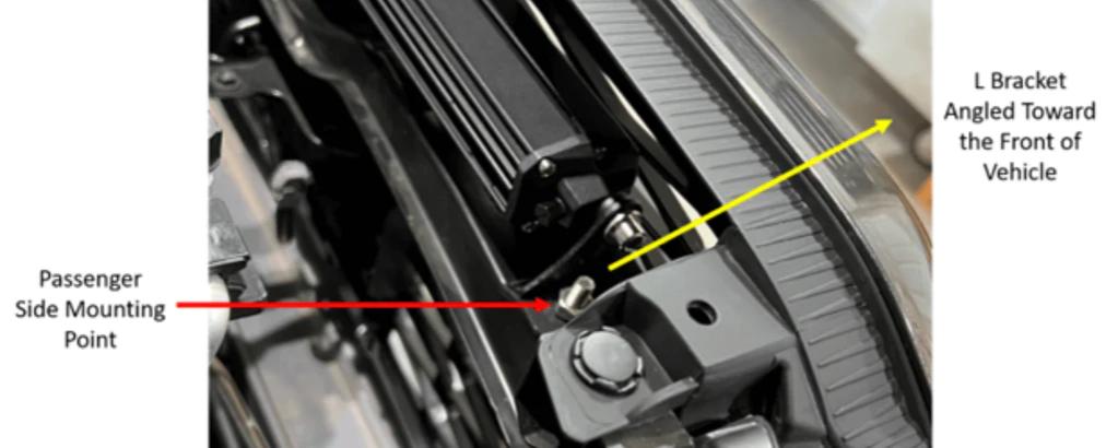

Step 5: Bolt The 90 Degree “L” Brackets To The Factory 4Runner Upper Grille Mounting Points.
Bolt the 90 degree “L” brackets to the factory 4Runner upper grille mounting points utilizing the Lasfit provided hardware: (2) Hex Bolts, (4) Larger Washers, (2) Large Lock Washers. (See pictures below). Make sure the “L” brackets are clocked in a way that pushes the Light Bar the furthest forward for maximum light output, and maximum flood capability.

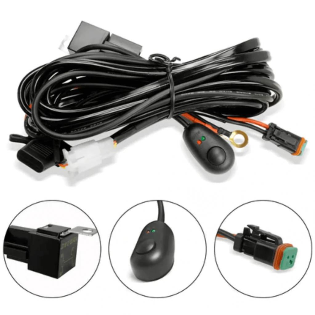

Note: There are many methods on how to power the light bar. The Lasfit kit comes with everything you need to power the light bar (when ordering the +Harness kit), including a power switch, super easy.

You can do this without cutting....
OP, this was my tutorial I made for Lasfit, I had to trim the TRD Pro grille part where the center bracket bolts to the back of the grille. However, on the 2020+ models I believe, we can't add that middle bracket back onto the TRD grille. This was an ORP vehicle that I upgraded to the TRD Pro grille. Hope this helps, Reach out to me if you have anymore questions...
Mike
i have a 2016, you can definitely do this without cutting anything, but good to know there are more than one way to install it in the upper grill.
