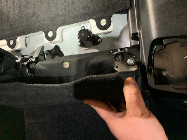

Pulling the seats isn't too bad. As others have said, pull the plastic caps with a panel tool then take out the bolts. Be aware, to get the seats out, once you have pulled the bolts from the floor you need to fold the backs forward and flip up the carpeting on the back fo the seats. There you will find the bolts that hold the seat in the side pivot point of the truck.
Good luck!
