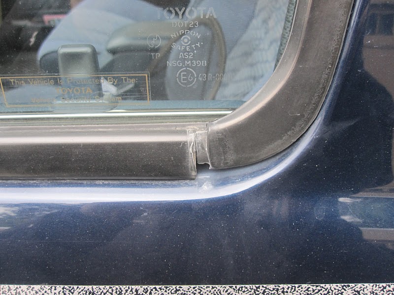

Anyone how how to fix this exterior window molding on my 1995 4Runner?
The 1stpic shows what I would like to fix on the drivers side

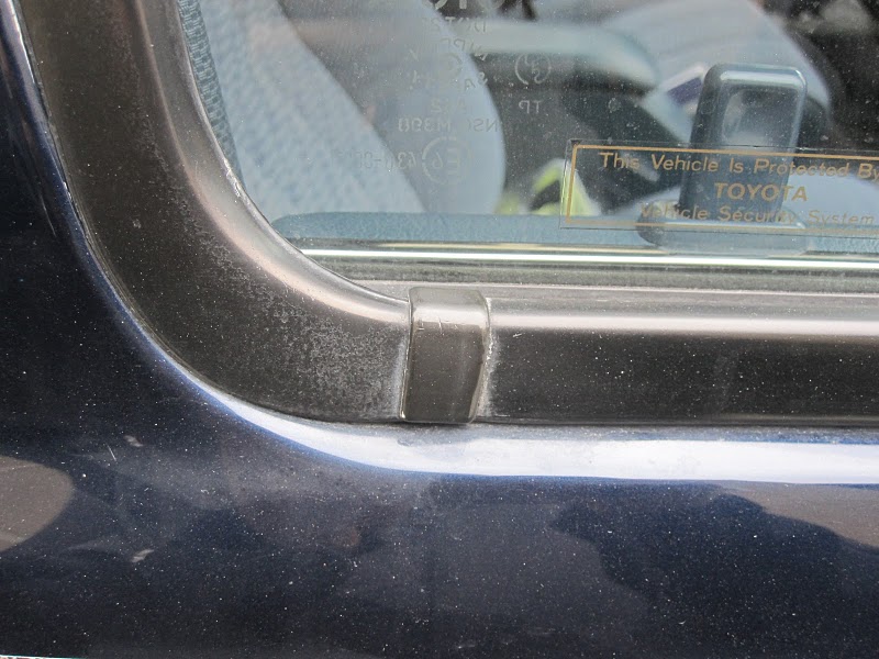

The 2nd pic is from the passenger side window, and shows the molding piece that is missing.
Any ideas how to repair?

I just replaced all of my 'weatherstriping' on all 5 windows after I replaced my front speakers and found out that water was leaking into the inside of the door when it rained or washed the car. All 5 pieces came to about $105USD from Coincelli Toyota.
The piece is easy to install:
Roll window all the way down
Remove door skin
Pull out weatherstrip (only held in by a tab on the strip)
Assembly in reverse order.:nerd:
