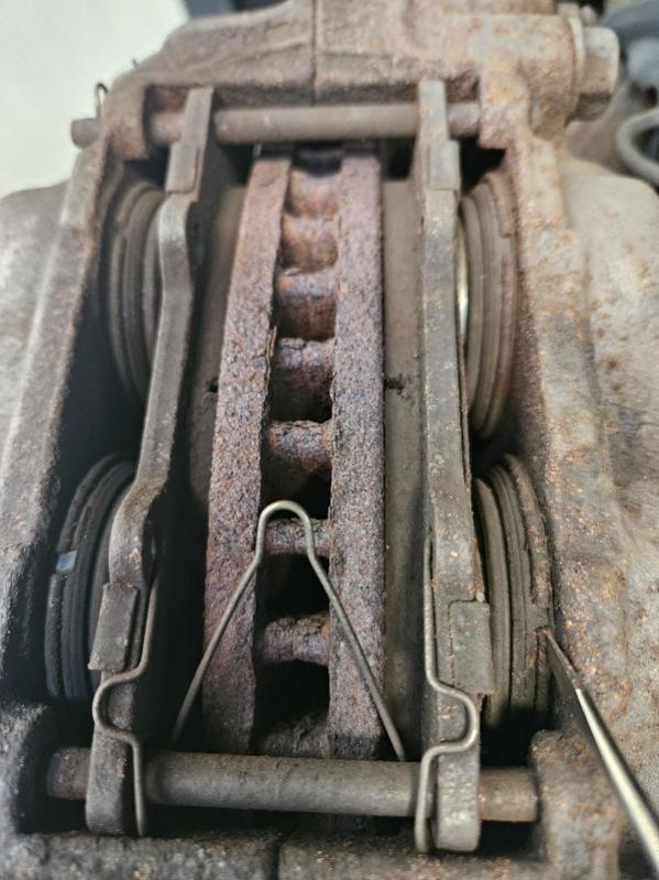

I wrote a reply over here that I believe is the real fix for this issue. What really happens is that water gets in between the dust seal/boot and the piston and sits in there. The tension of the "C" clip that secures the dust boot to the caliper needs to be tighter than they are. Plus when assembling there can be no gap or wrinkle in the dust boot where it contacts the caliper body. Just a wild guess here, but if you got your brakes reasonably hot on a regular basis (cooking out the water) it might help, or as suggested before, take your calipers off and inspection them on a more regular basis.

Interesting, there are no c-clips in my caliper dust boots (none of them)
Here is a picture of the "C" clips on the dust boots. The screw driver is resting right on it. You can see the other three with all the gaps in the same direction. Looks like it's time for pads and rotors again.
