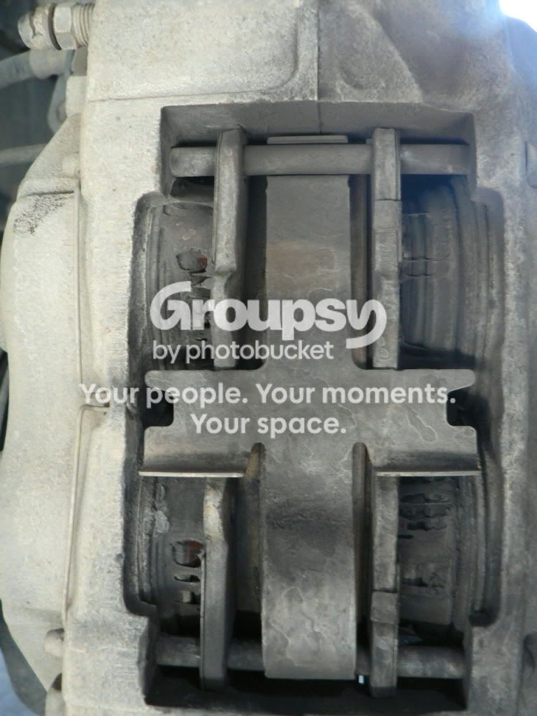

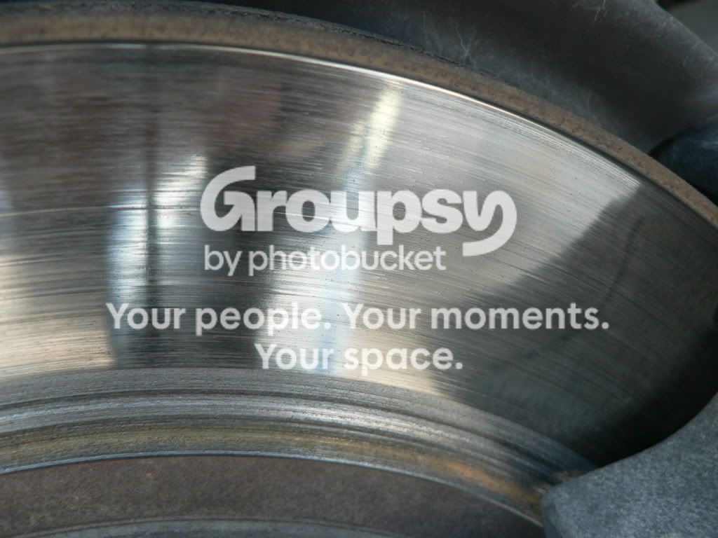

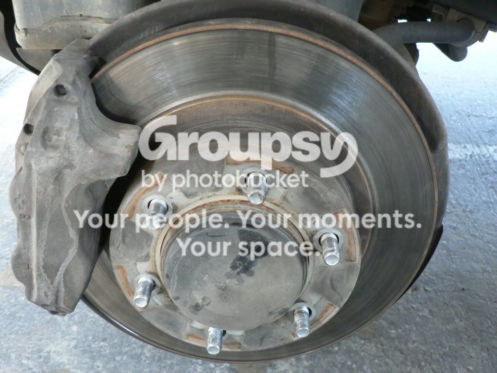

Rotated my tires today and has a chance to check my brakes (bought 4R in sept). The brakes started making a grinding sound when coming to a stop at low speeds about a month ago. No wobbling though. This is what I found...
Left Front...

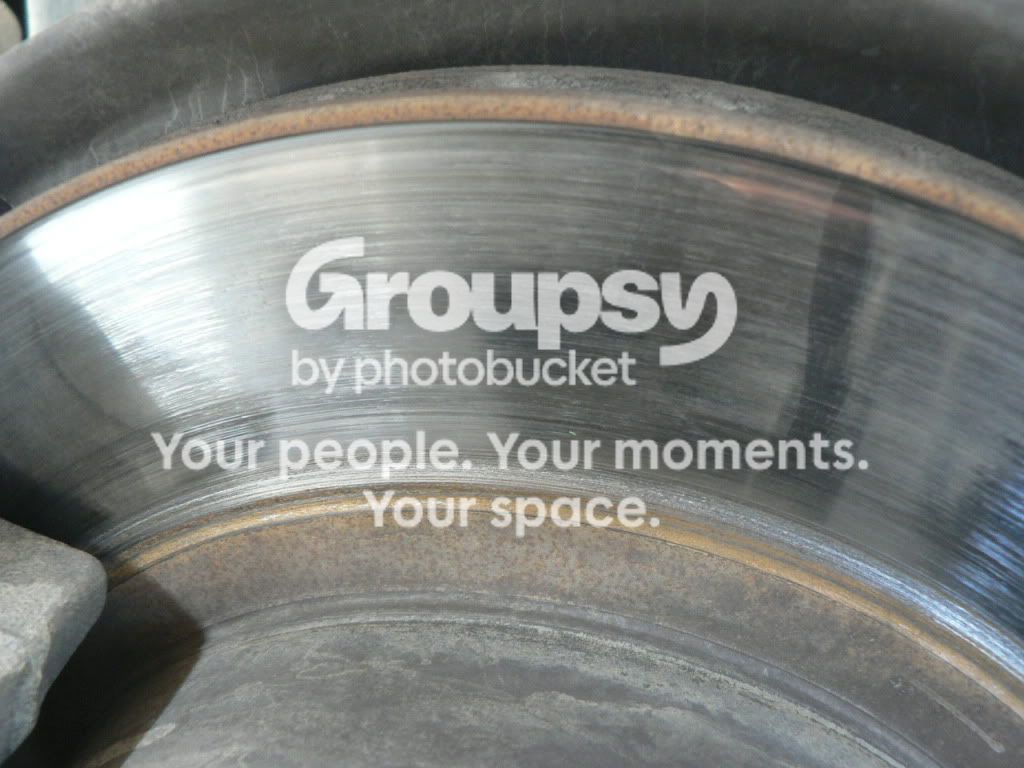

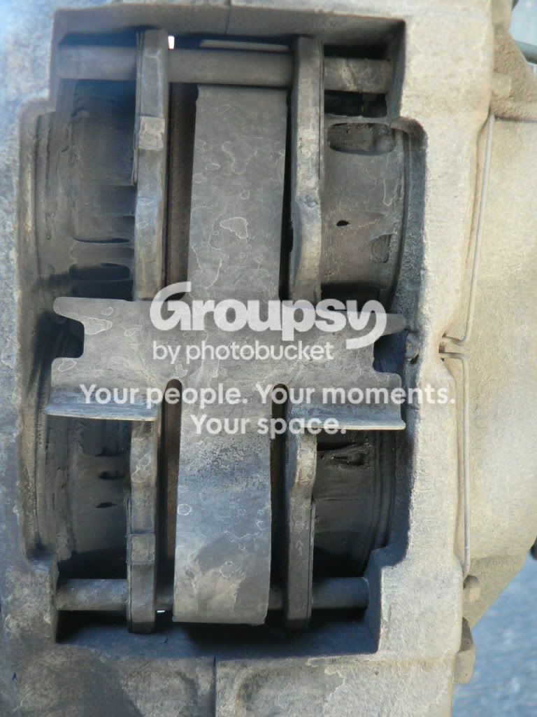

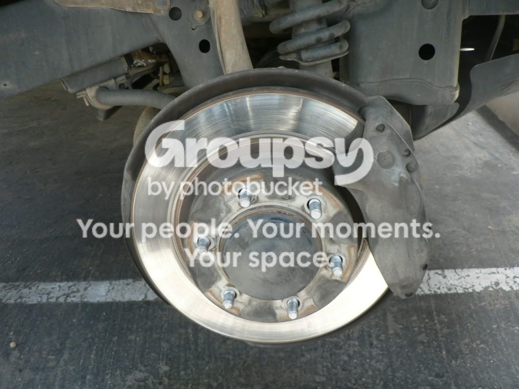

Right Front...

Both sides the pads look like they are almost gone. Also on both sides looks like there has been some metal on metal contact. This can been seen on the inside area of the rotor? Must be the grinding sound.
My question is should I replace pads or go for the Tundra upgrade? I plan on doing the Tundra upgrade at a later date as I would like to use money for other things right now. I have read the upgrade can be pricey especially since I don't have good access to yards. Pads on the other hand would be cheaper and hopefully would last a year or more. Just don't know if the rotors are that salvageable with the metal on metal contact.

You need more than pads anyway. Your calipers are f'd up, your rotors look to have some scoring, go with the Tumdra upgrade. I have the 199 kit also, it's so much better than the stock set up.

I agree with all of them. :iagree: If you are planning on doing them in the future, go ahead and do them now. You do need new pads and rotors. Also those calipers look messed up. Do the upgrade and appreciate the braking power that comes with it.

lol, this is true. Well is seems unanimous that I do the mod instead of the pads. Did not know the calipers were messed up along with the rotors. Glad I posted pictures
