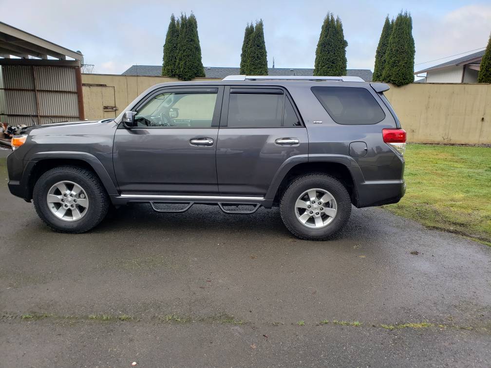

This is what I did with my 2012 SR5 Rockers. Cost me $100 to enlist a Friends son to help me. Ray cheaper than the stock or Shockworks Rockers 20201212_110558.jpgView attachment 373663View attachment 373662View attachment 373664
