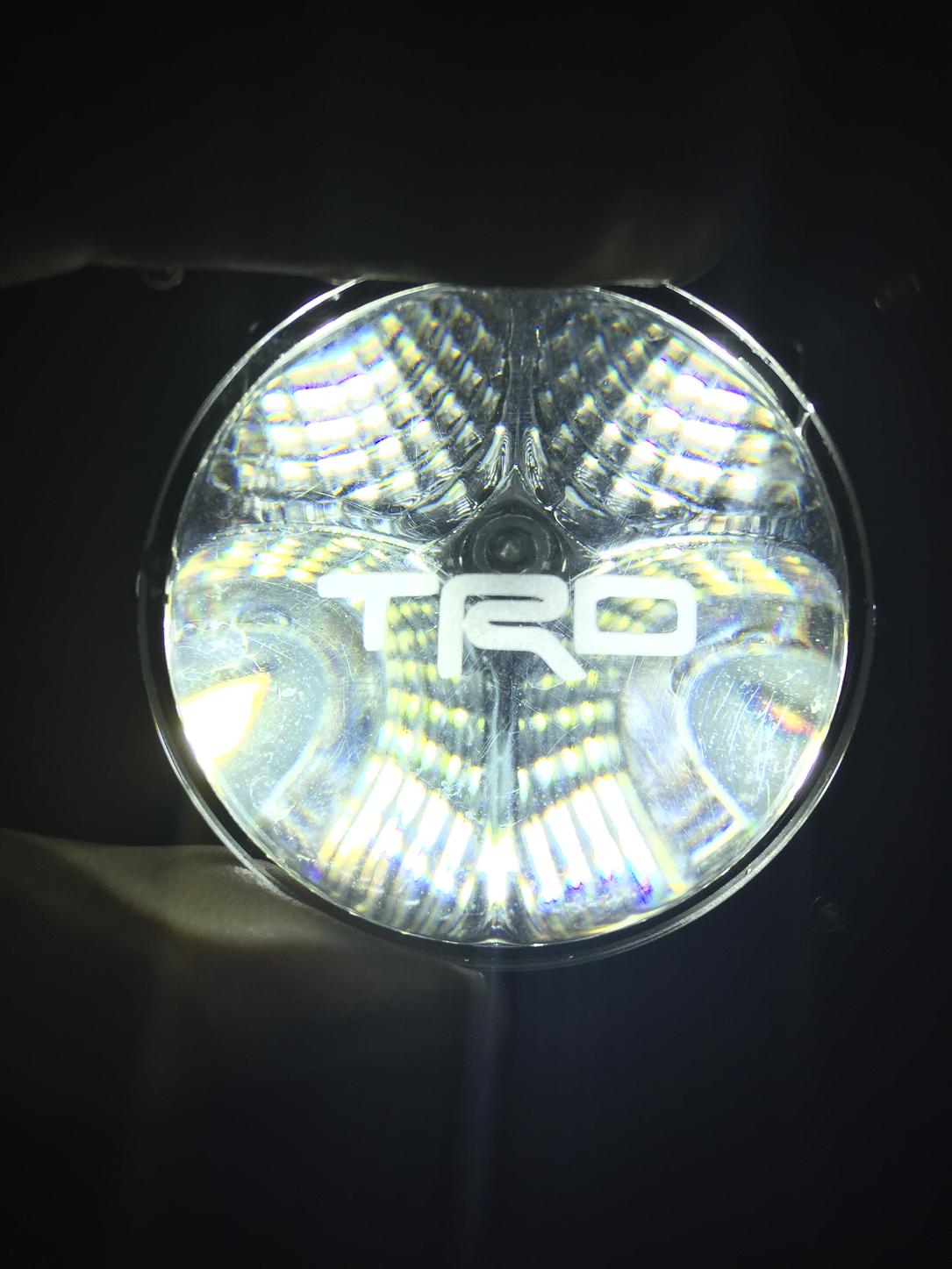

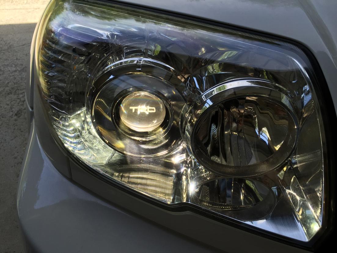

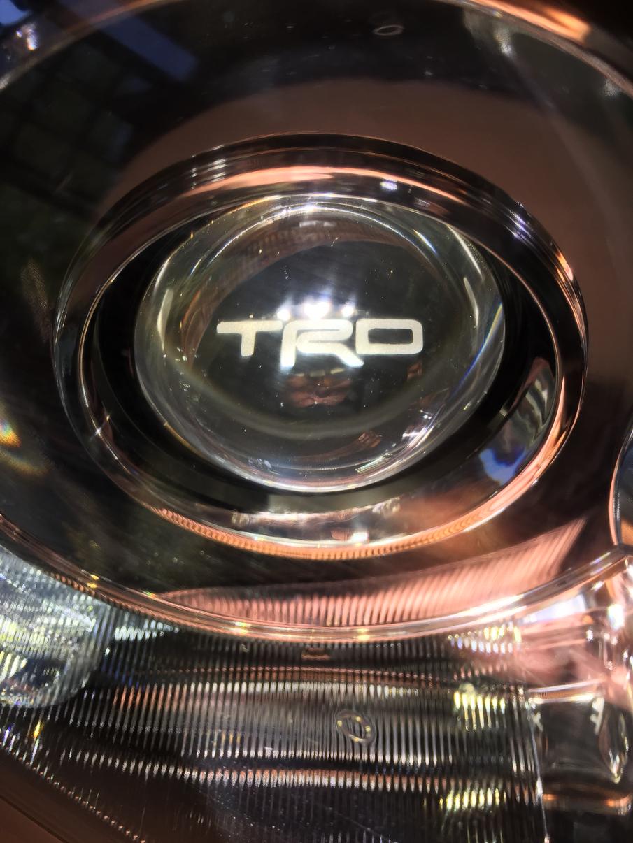

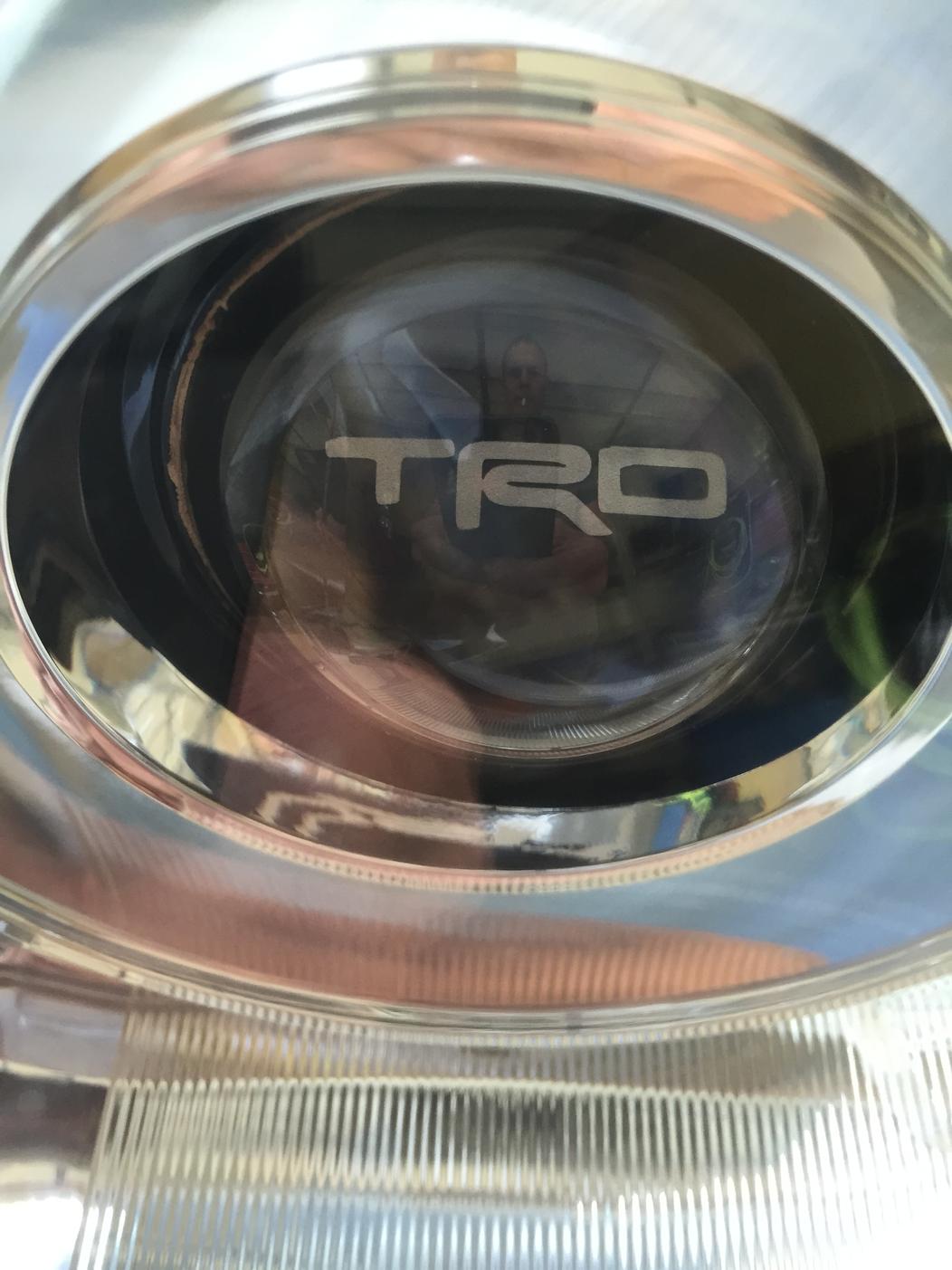

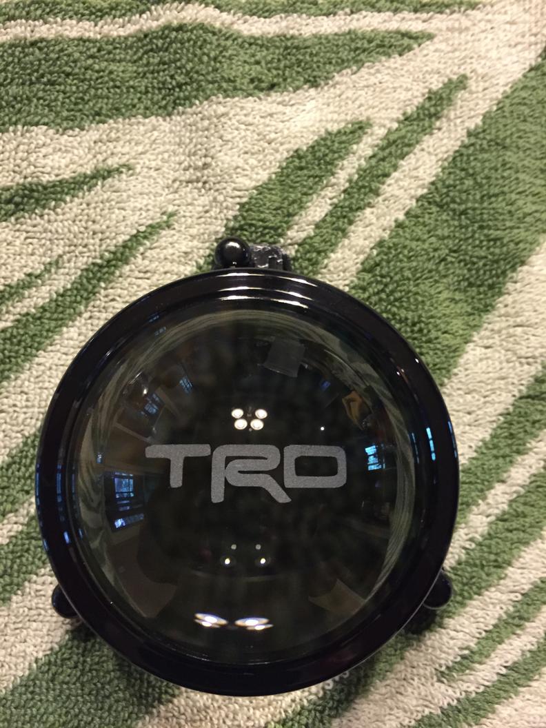

I installed the HID system from Retrofit Source last week. With mine being an 08 I already had the projector lamp. I had the LMZ LED's in it prior and while I liked the nice clean white light it lacked the ability to throw the light like I wanted. LED lamps are crippled inside of a projector lamp assembly simply by the design and function of a projector.
A good friend of mine, Tomas Chinchilla is friends with the owner of TRS. He hooked me up with the HID system and showed me the difference between the factory lens and his lens. It was very easy to see the clarity and how much more focused the light is. He also showed me how they can stencil/etch a logo onto it. While he had some pretty neat logo's as examples it was the TRD logo that caught my eye. I said what the hell, I'll swap mine out and have him put the logo on them.
It is very subtle and I like that. It does not project the logo on a wall for example. Thank goodness.

Can you tell us some more about this "new" lens you installed in your projectors? I've seen the clear lens that TRS sells...is this the lens you installed? Do you have any before and after pictures?
Yes, I installed the clear lens. Just by looking at the 2 different styles your naked eye can see the difference. Much more clarity.
I just did the lens swap yesterday afternoon. I will take some shots this evening.
