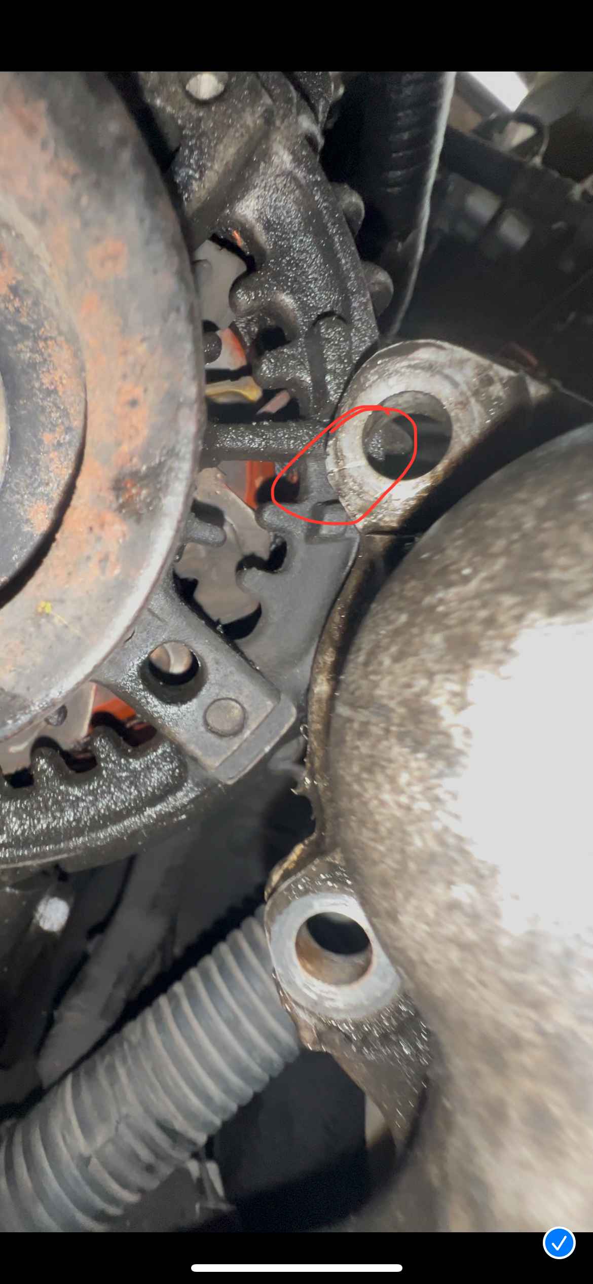

The 3 studs in the pic correct? If so they go into steel not aluminum, thread into the block itself. Helicoil is best option at this point. It would suck but it would be best to remove the water pump to do the work.
ETA - make sure the stud threads are ok, I've seen the threads on studs strip too.

Correct, per your picture it's the left-most stud. Thank you... grabbed an M8 - 1.25 UNC (based on some other threads I found while searching for answers) thread repair kit. Going to grab replacement studs and nuts, try them first as it couldn't hurt.

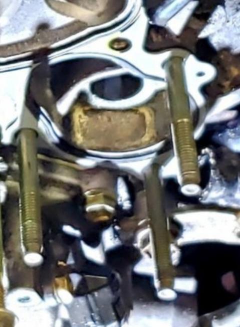

Replaced the housing + the original stud, I can now torque it down!! However, there is still a slow leak...steady trickle. Gasket not sealing? Dirty mating surface?

Is there just a gasket or gasket with some type of gasket sealer?
If just a gasket you might want to add some gasket sealer on both sides of the gasket.
You have 2 gaskets in that specific area unfortunately. One is the split o-ring that goes around the thermostat. Then the water pump gasket that goes between the water pump and block. If it was over torqued enough to crack the outlet, I'd guess the water pump gasket is smashed to much. The water pump gasket is metal with a rubber overlay on the inside to seal things up.
Happy you were able to fix the stud issue! Was it bad threads or a bad stud?
Copy that! The leak ended up being my fault as I had the ground between the t-stat housing and the block... leak was resolved after I relocated it between the housing and nut, where it should have been. :frusty:
Bad stud! The original would only thread in about a turn and a half... when I tried the new one it kept going and going and going- huge relief there.
