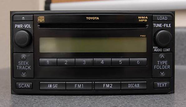

You sure? I'm not replacing a JBL unit, these are both the Pioneer units. Here's a picture of the new stereo...

I would measure them both horizontally where they go through the bezel. I replaced a standard system with a 2005 JBL single disc head unit which fits factory clean. With the Ipod adapter I don't need to play discs much now. Also, what is broken on your present stereo? I found that all the 4th gen radios except for the 6 disc (JBL or otherwise) have the exact same cd player and cassette player whether from a Tacoma, Sienna or 4runner. Just remove the top and bottom covers and front panel and remove a few screws and they both unplug from the radio board.

Yes - measure height of the 6 CD face plate --- it is different than the single CD unit --- which results in you having to change the trim surround pieces and the AC/computer controls. VERY costly plastic pieces new at the dealers.
The link to Sharp4Runner's install covers it - he swapped all the trim pieces with another 4RNR owner.

The Scion Head units do fit, with no trimming, etc. If you have an iPod, you can forever forget the CD player. I thought I would use my CD player with MP3's and WMA'a; but I never have. Get the iPod cable on eBay, as it is a pain to pull all the cables from a Scion car. They also support some type of satellite radio.
These units sound much better than the original 4Runner head units (except maybe the JBL). I like this model T1806, because it has knobs, and not entirely push-button controlled. Personal preference. The T1808 also has knobs.

hmm i measured the height of each and they seem the same or nearly the same. although i could not get a totally accurate measurement on the old one as it is still in my 4Runner. does anyone know what the difference in height is? i could not tell any my first measure...
