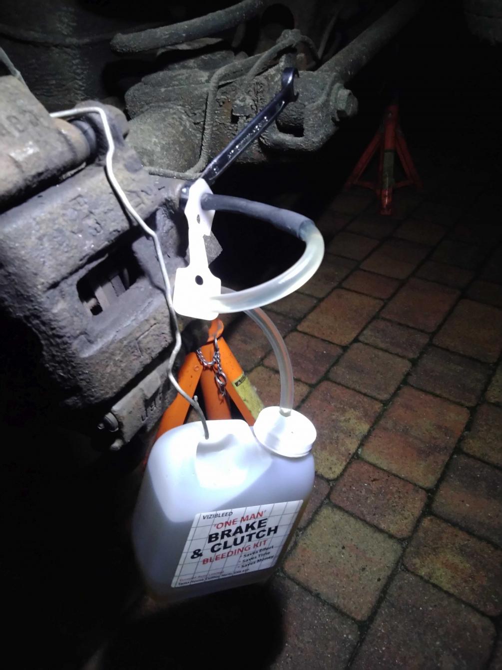

I did it manually without any problems as described in the service manual and Haynes.
Used that simple and cheap bleeding kit with one way valve at the end of the tubing.
I could theoretically do it just myself but had an 8 year old helper pumping the pedal :) It took up about 1 liter of fluid.
