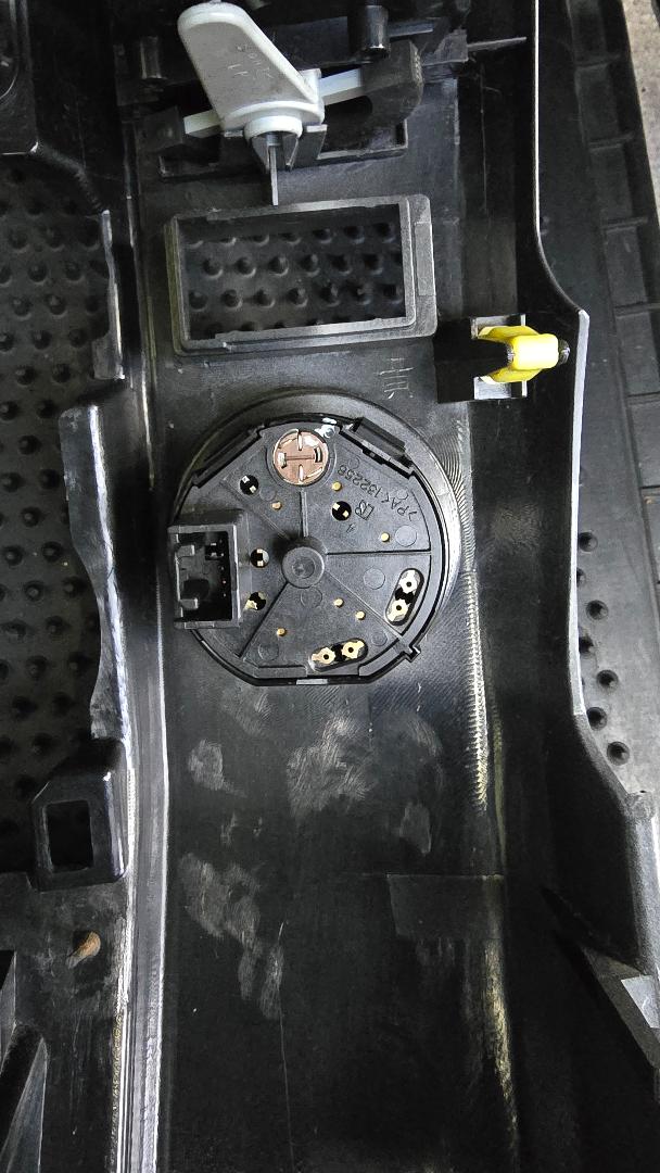

It’s easy. There are a couple of tabs on the 4x4 switch assy. Just squeeze one or two of them and it should pop loose.
I’m not back home till Sunday and I have a spare switch and trim panel and I can take a couple of pics for you if it will help.

Here is a pic of the backside of the panel that houses the 4x4 switch. At the 1 o'clock and 11 o'clock position and again down at the bottom 6 o'clock position are the tabs. Just push the tabs in a little and it will start to pop out.
Pic attached.
