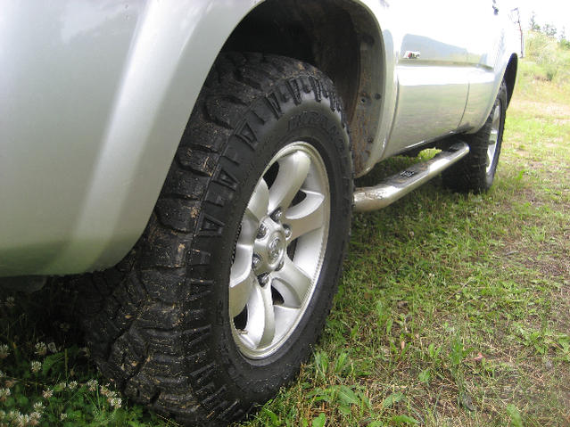

I love my GoodYear Duratrac A/T!! Check them out, I got mine for $205. Not loud on the road, great off road, Snow rated and look good! can put #16 snow studs in them if you need to... I don't think I will need to even in the Colorado snow. This tread is mean and deep!
