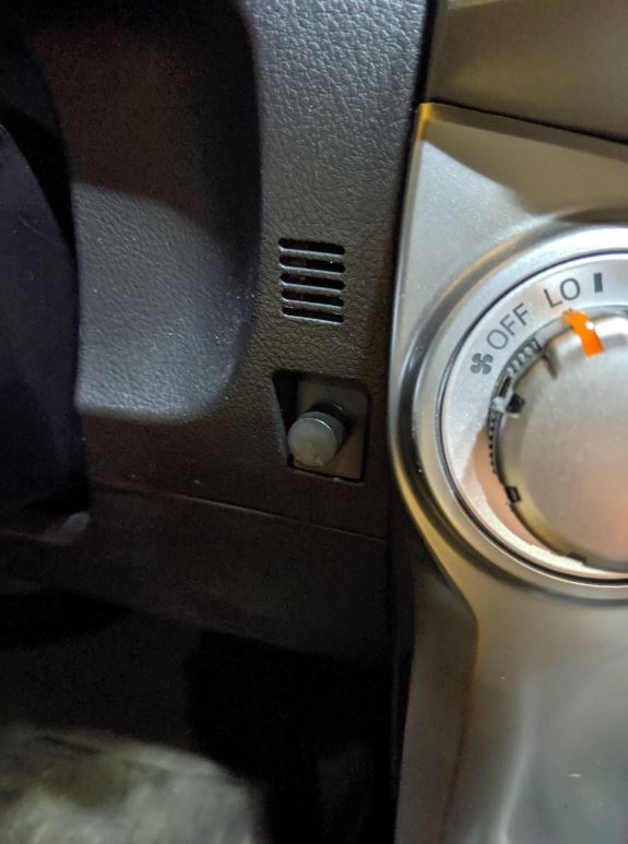

I didn't have a party mode button because I have a lower trim, but I ended up replacing my entire stereo system anyways. I had the installer put in a subwoofer volume knob in that location instead. Works for me :) What kind of party would it be without BASS??
Very cool. I ended up putting mine in the stock USB location, had to modify the hell out of a blank but it was so worth it.
