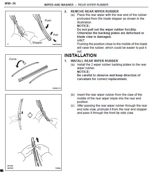

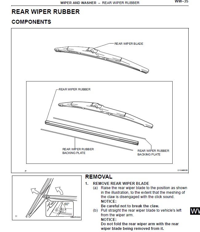

From the Repair Manual
At last the wiper gods gift us with this revelation!
Heh, awesome man, thank you, that confirms my suspicions of being on the right track. I knew it couldn't be any more complicated than a typical wiper, my blade is just stuck from road crap.
Thanks a bunch for the pix.
I was at the dealer over the weekend getting a new air filter and it turns out the new wiper blade assembly was only $13 -- twice as much as an insert but worth $6 extra to avoid fiddling around in the cold and to get nice new black plastic on at least part of the wiper arm :)
Getting the old one off took a minute. You have to flip the blade to almost 90 degrees to the main arm, which means the end is jammed up against the window but gives just enough room to unclip it.
Thanks for posting the insert replacement diagrams.

Just followed the instructions above and perfect!!! Here's the parts number for the REAR INSERT. I have been buying the inserts ONLY forever. Seems ridiculous to replace the arms.
Parts number, 2003 SR5: Rubber, Wiper Blade 85214-22440, dealer cost $1.21 (or something like that)
