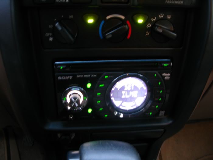

Here is a picture that sucks.
So far I really like the Sony...looks cool and not so flashy that you have to worry about someone ganking it.
I will get some better pics this weekend after I install my components, amps and subs...it will either be this weekend or next weekend b/c I am planning on taking all of the seats out, carpet, etc
Looks great!! Does it fit in the stock opening or does anything need to be modified? This may be the first thing I do to my RUNNER! Are you installing new rear speakers or just fronts? I would like to see about putting 6 3/4's in the back but hear there is some work to do so.
It fit the stock opening with no modifications at all.
