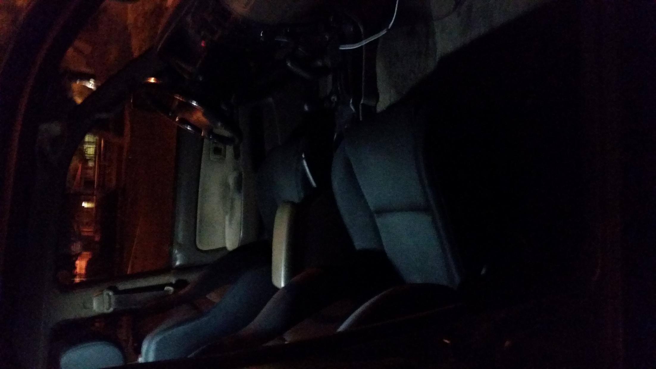

my solution was to swap in highly modified scion xb seats.

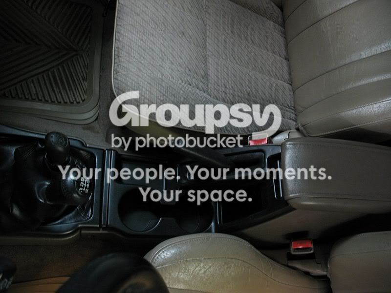

I swapped the passengers side seat bottom with the drivers and thoroughly deburred the steel part of the seat frame that causes all the cracking/ripping on the exterior side. The new/old bottom has held up just fine.
The passengers seat bottom has temporarily (3 years now?) been a similar color cloth while I get the original drivers piece repaired (possibly never at this point).
the temporary setup also showcasing my 99 center console
