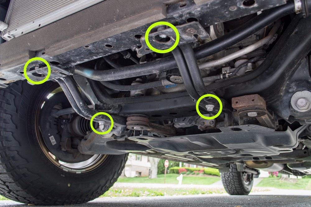

I'll be honest in that I have no idea on the actual bolt dimensions, but this plate does not mount to threads of the original bolt holes. It mounts to the bolts of the frame support which will need to be removed. I pulled this image from this site:
Car Trim Home TRD Skid Plate Review & Install For 5th Gen 4Runner
I used the bolts and spacers included with the plate on the 2 bolts closest to the radiator. I reused the existing frame support bolts for the rear.
Ooohhhh! Frickin' LIGHT BULB! Thanks a ton. I was very confused looking at the stuff I pulled off and what I was sent. The instructions make some more sense to me now as I had an assumption that the new fasteners went where the old ones went. Looking at it in that pic, the spacers make sense now too.
