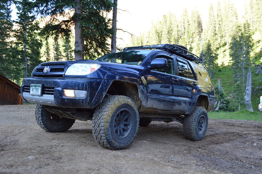

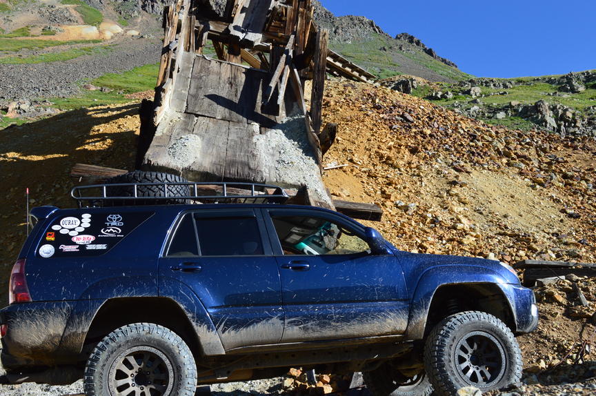

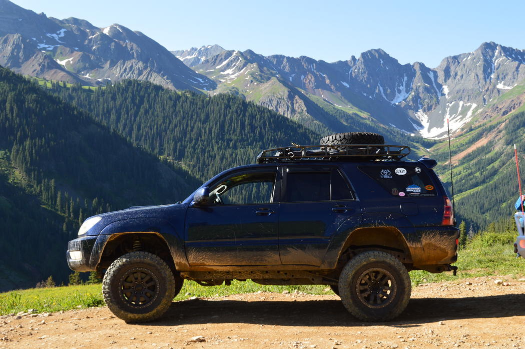

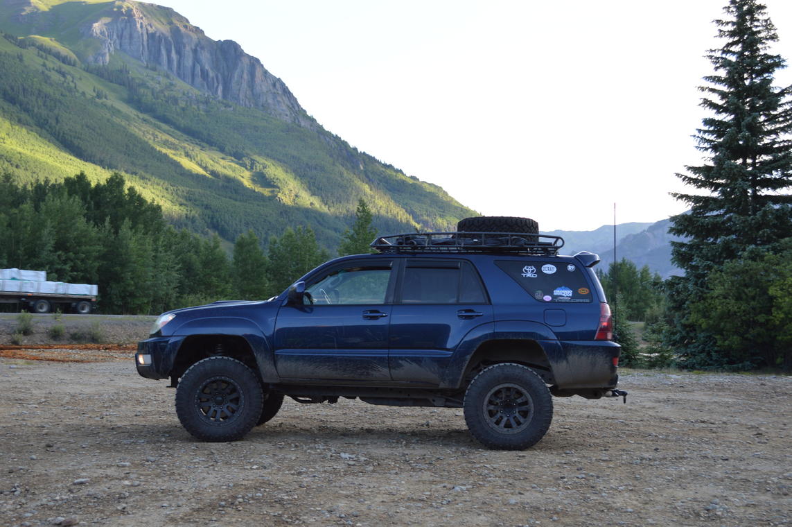

I also have a 2005 V8 Sport edition. It has been through several different lift combos. It started with the Cornfed 3/2 lift. Then, we went with a Toytec ultimate with Light Racing upper control arms. It now has a Toytec Boss kit. The ride quality of the Boss kit is amazing compared to the ultimate. Well worth the money.
Did you require UCA's on any of those setups? What mileage do you have on your current setup? Also did u stay with the 2.0 coil overs or upgrade to 2.5?
