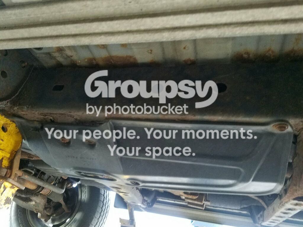

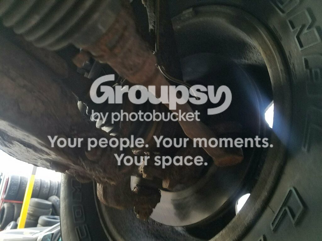

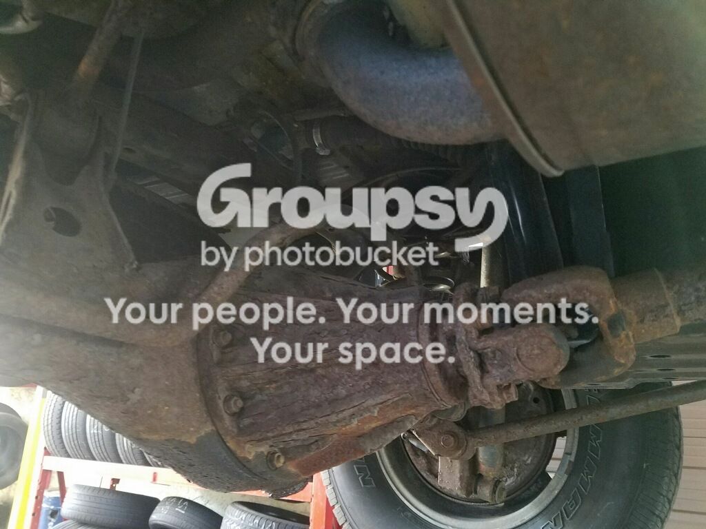

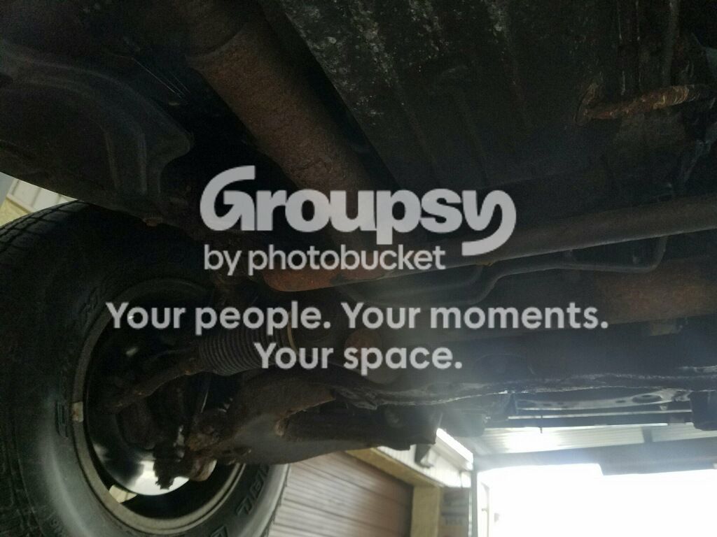

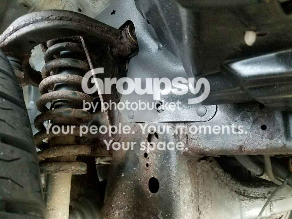

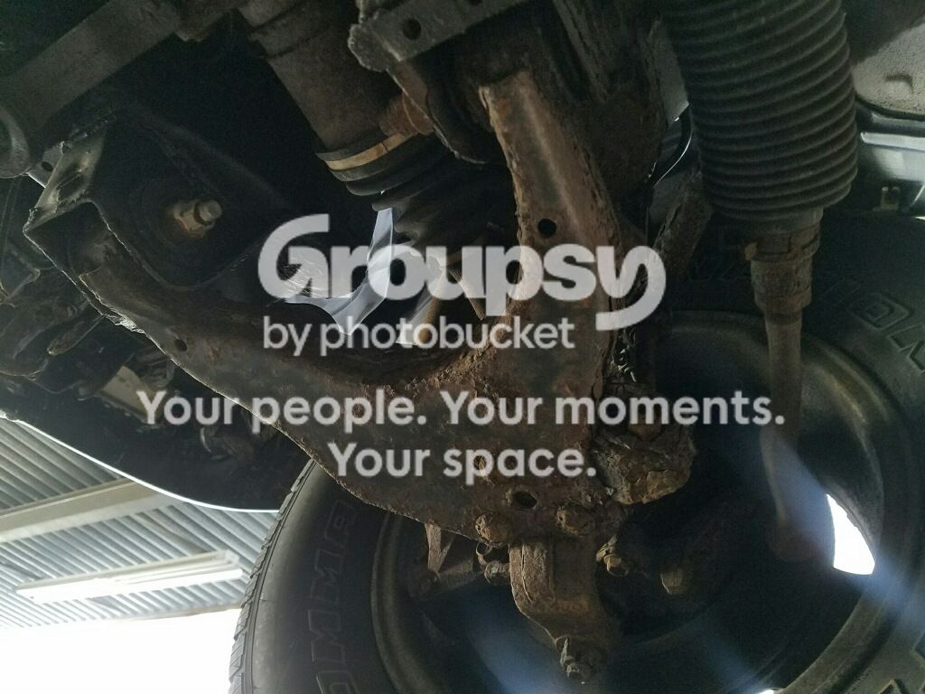

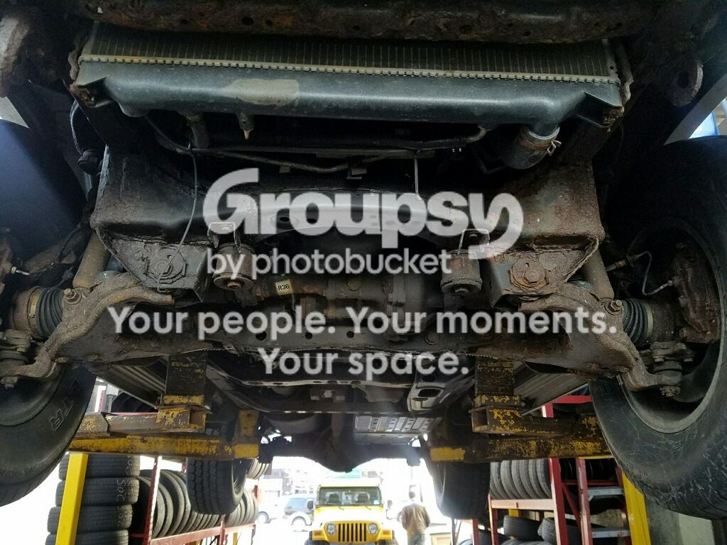

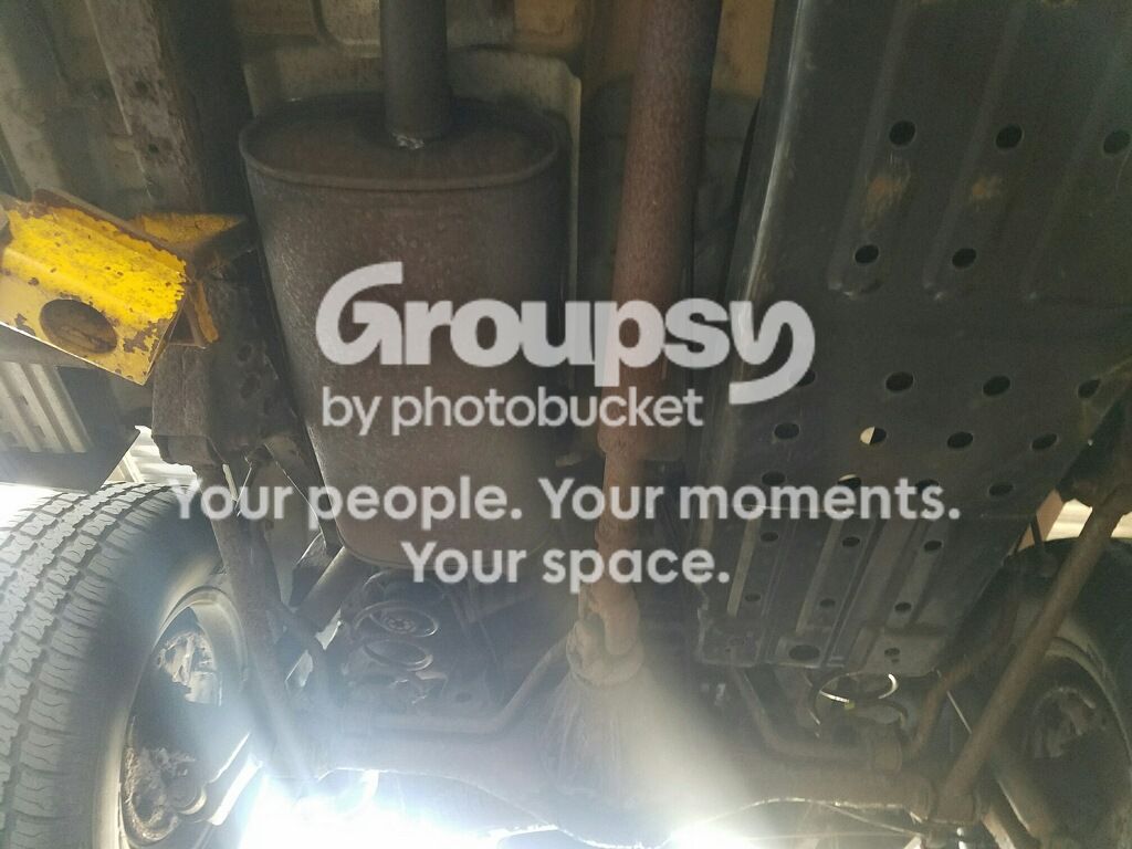

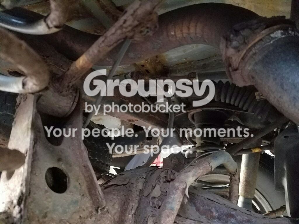

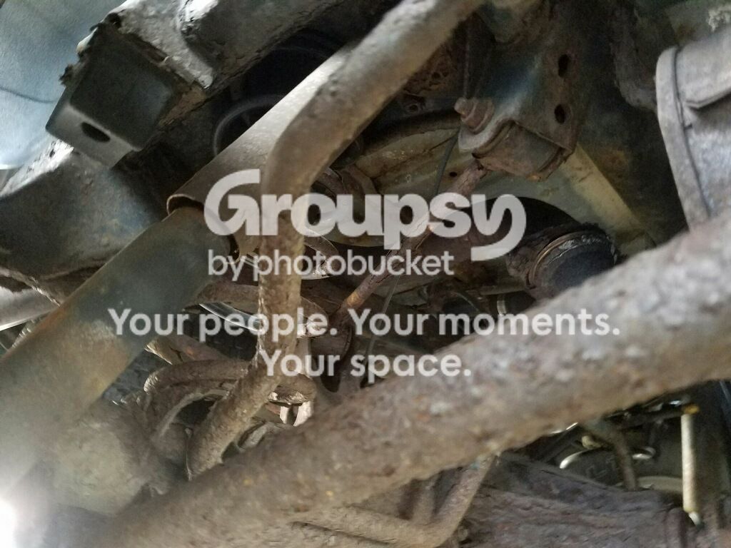

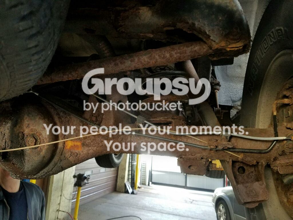

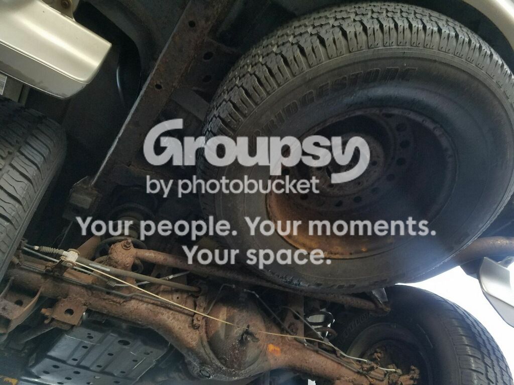

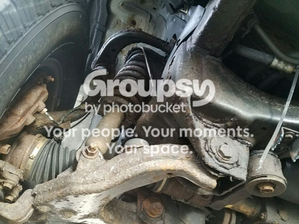

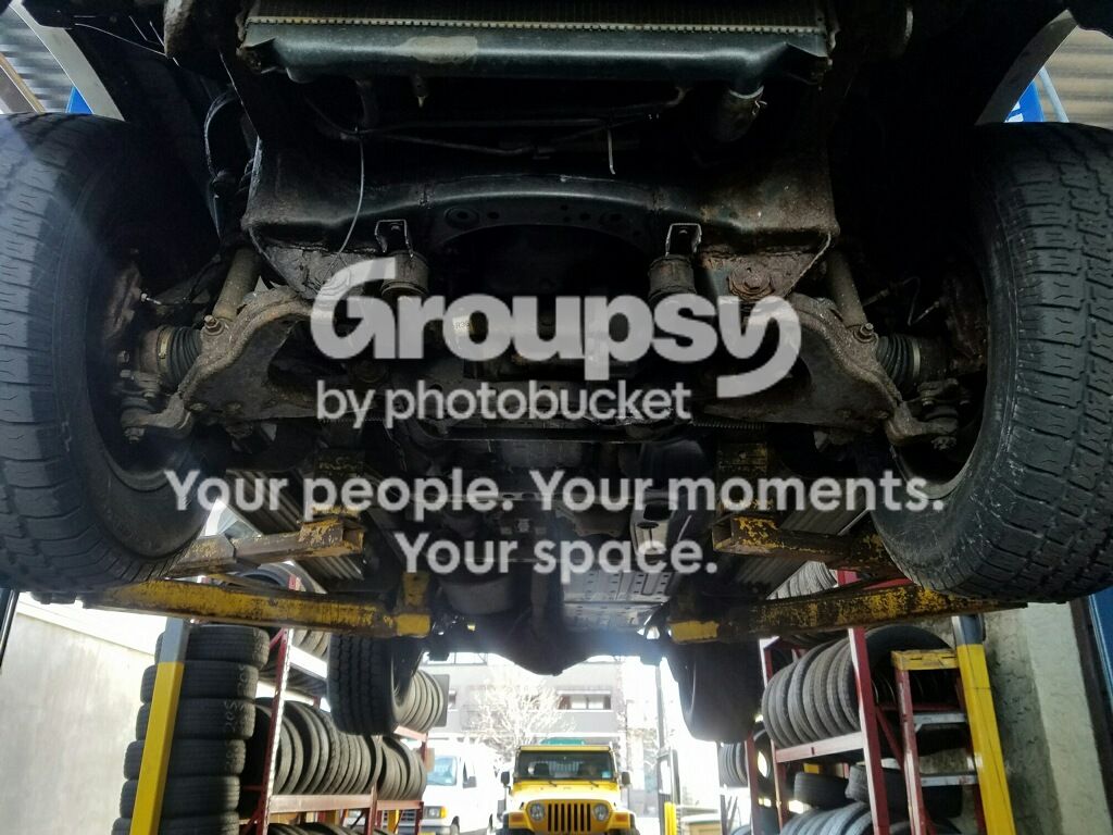

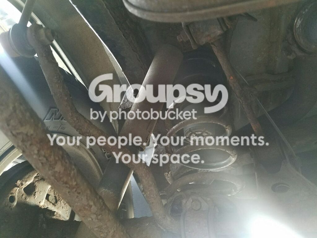

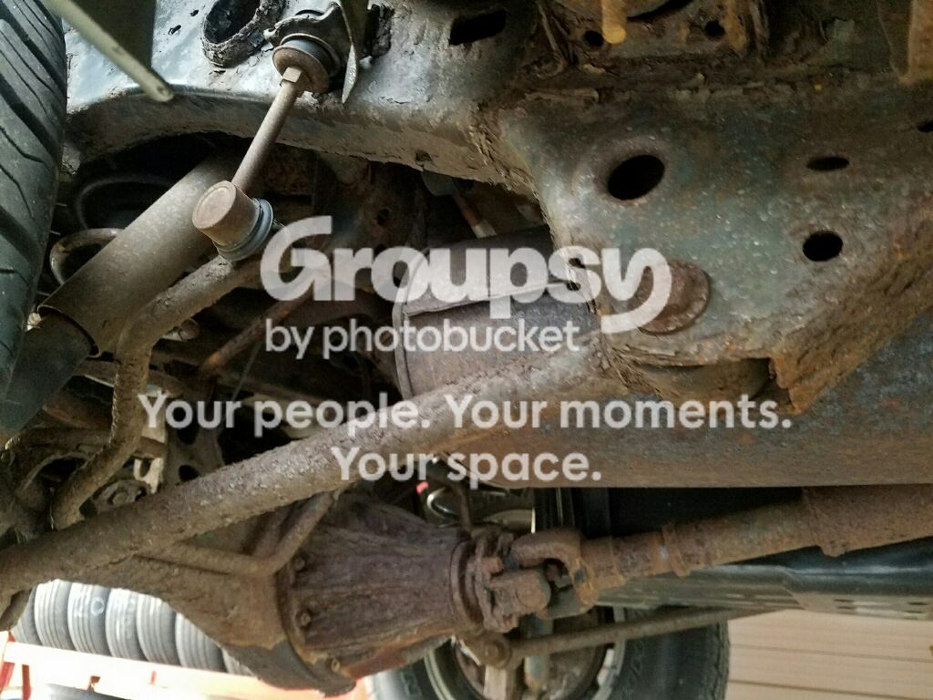

Found a SWEET runner. Super low mileage, has been babied its whole life. All service records. But the rust is there. Anybody mind me emailing them the pictures? My gut reaction is to pass, but this is the perfect scenario truck, low mileage, one owner, etc.

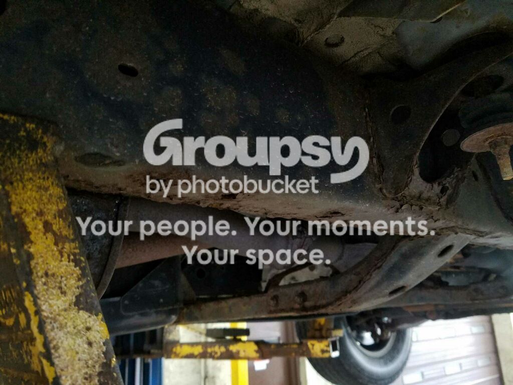

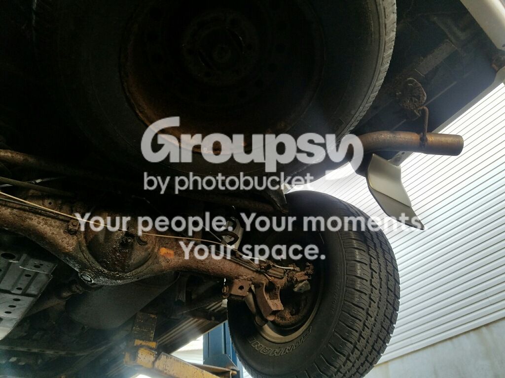

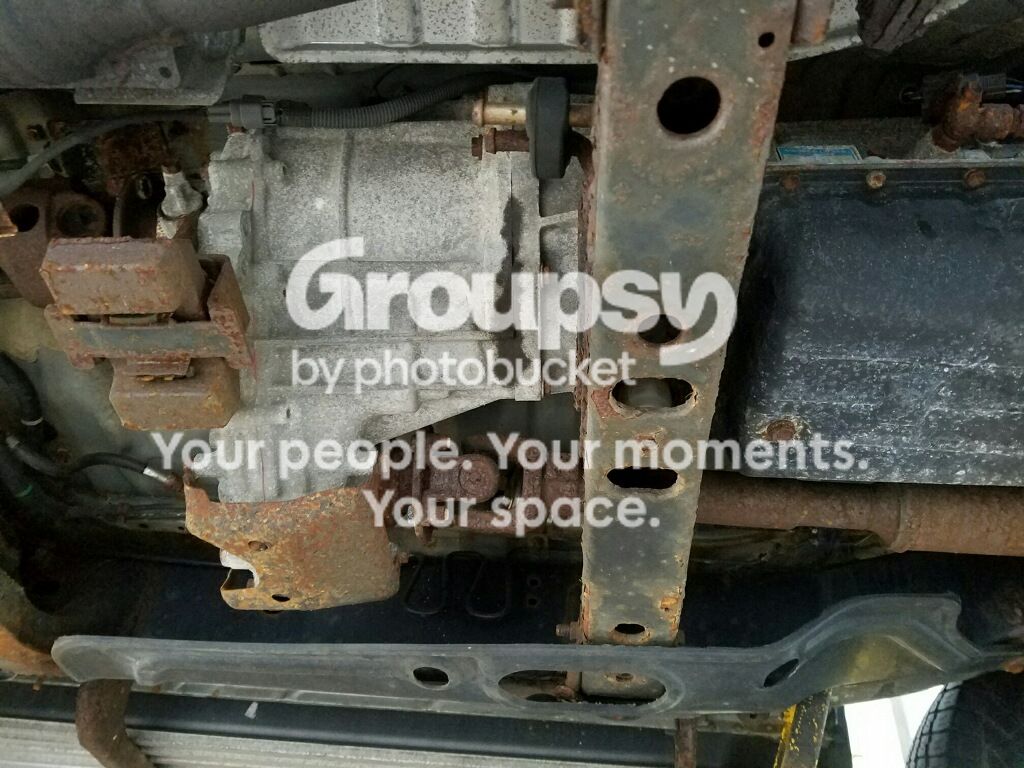

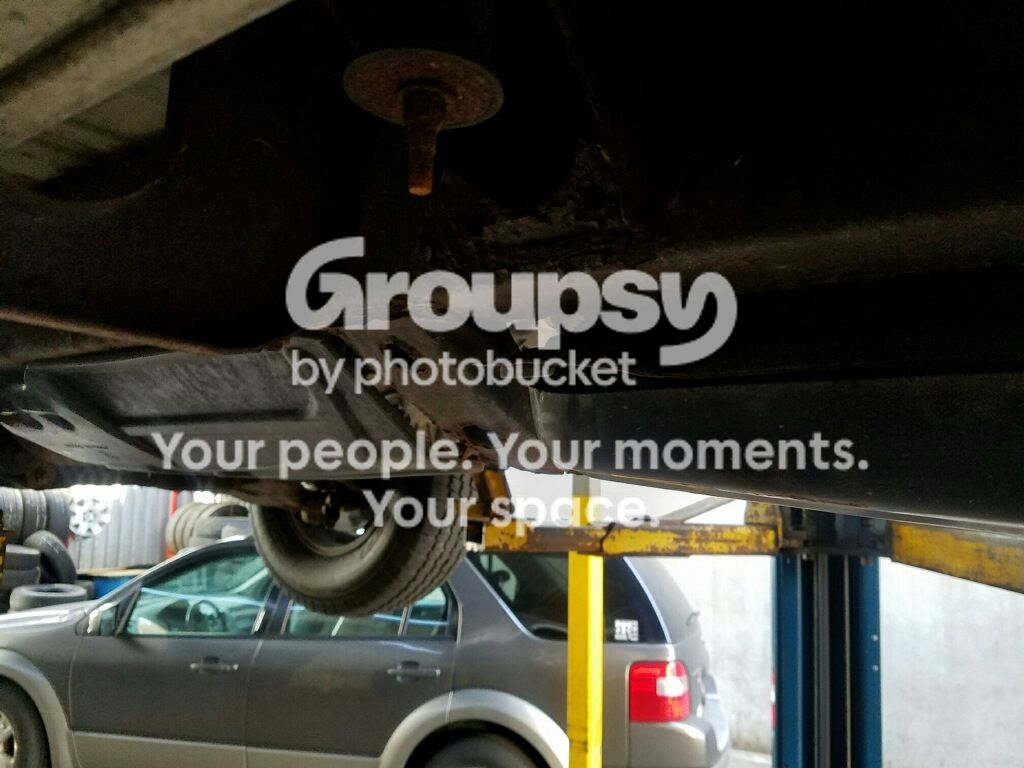

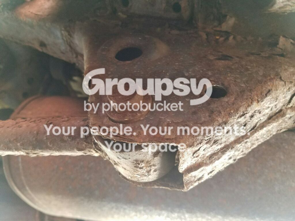

Can post pics on this thread to and draw in more people...get the rear lower control arm brackets, transmission cross member mount area, under the front doors where the frame curves in to clear the wheels, and the cab mounts.
My Taco's cab mount sheared off, and then I found a 7" perforation in the frame right under the driver's door.

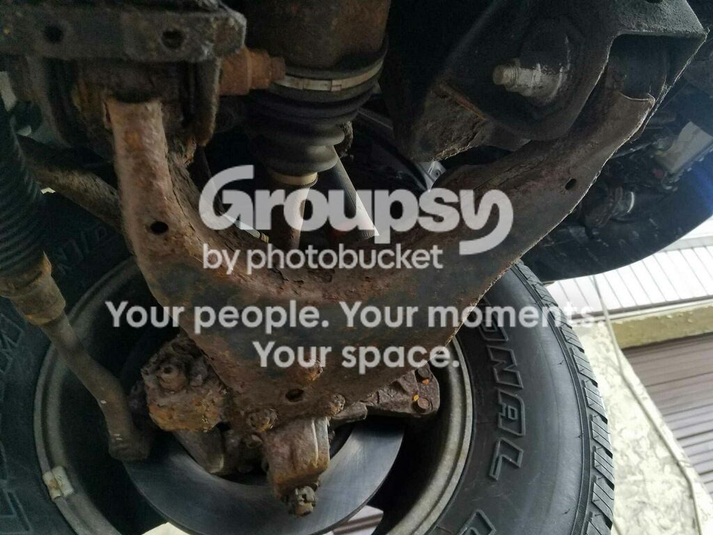

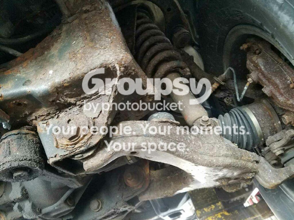

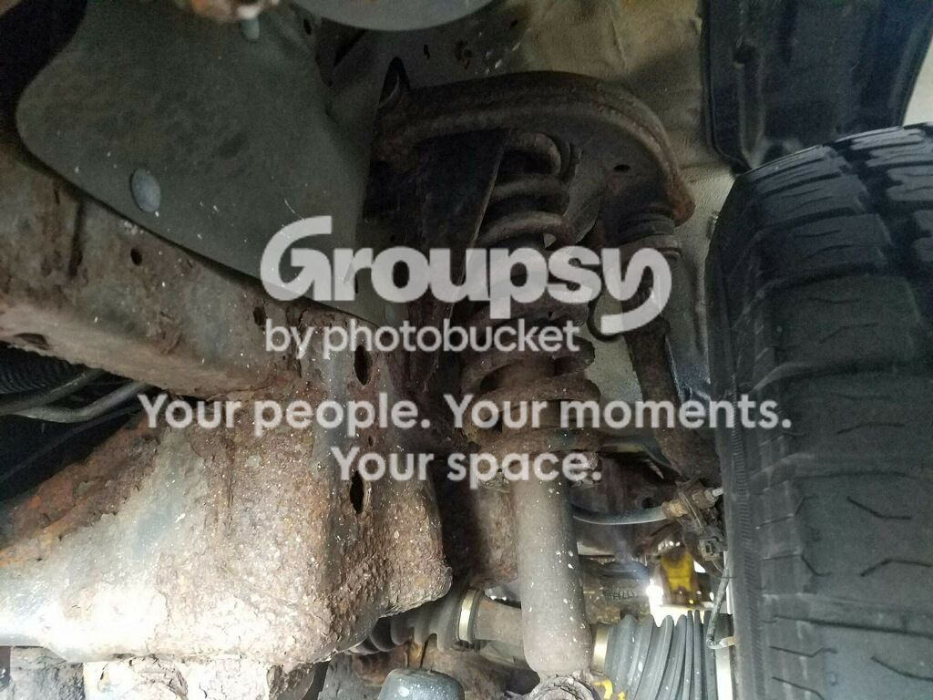

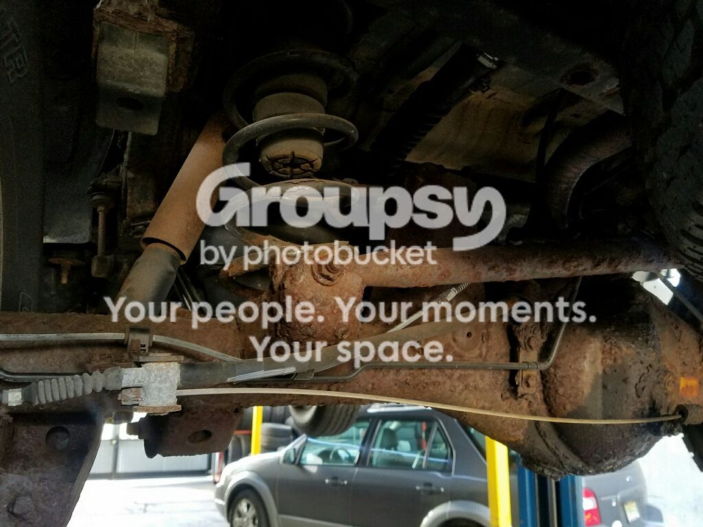

That is a no...unless the price is right for the body and parts to sell off. Almost all of your control arm mounts are going to bust off...I doubt you will get any bolt off of that axle/drivetrain without snapping it.
That is a bad one...

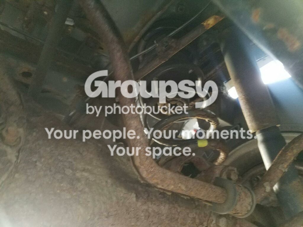

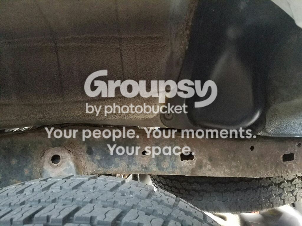

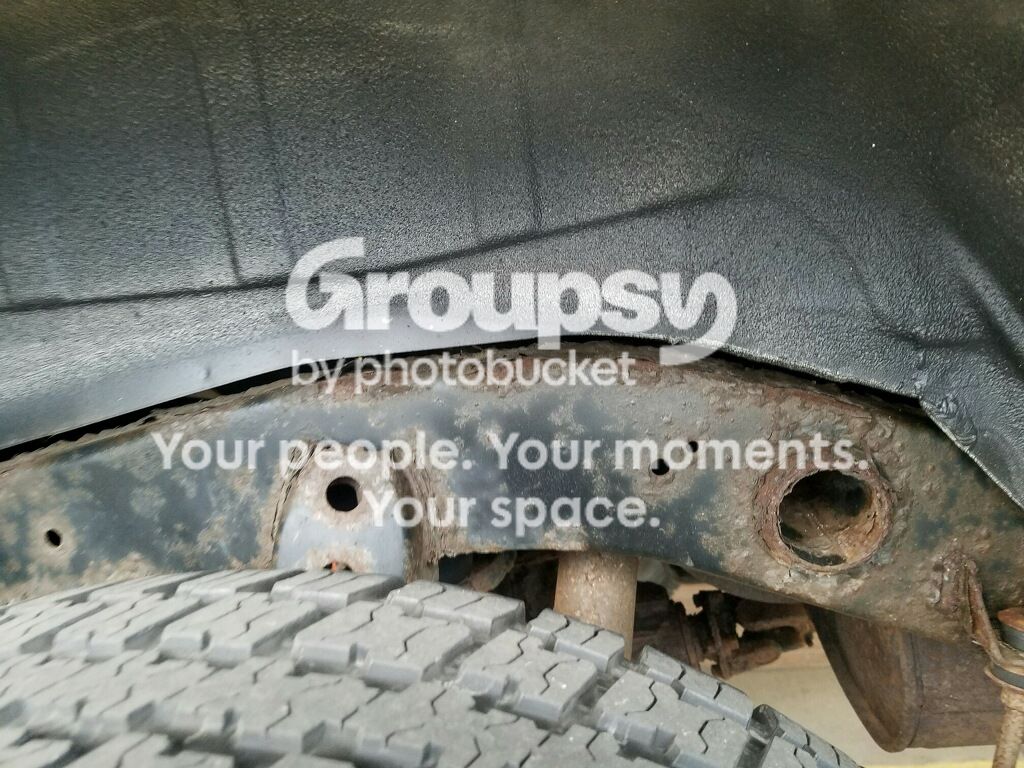

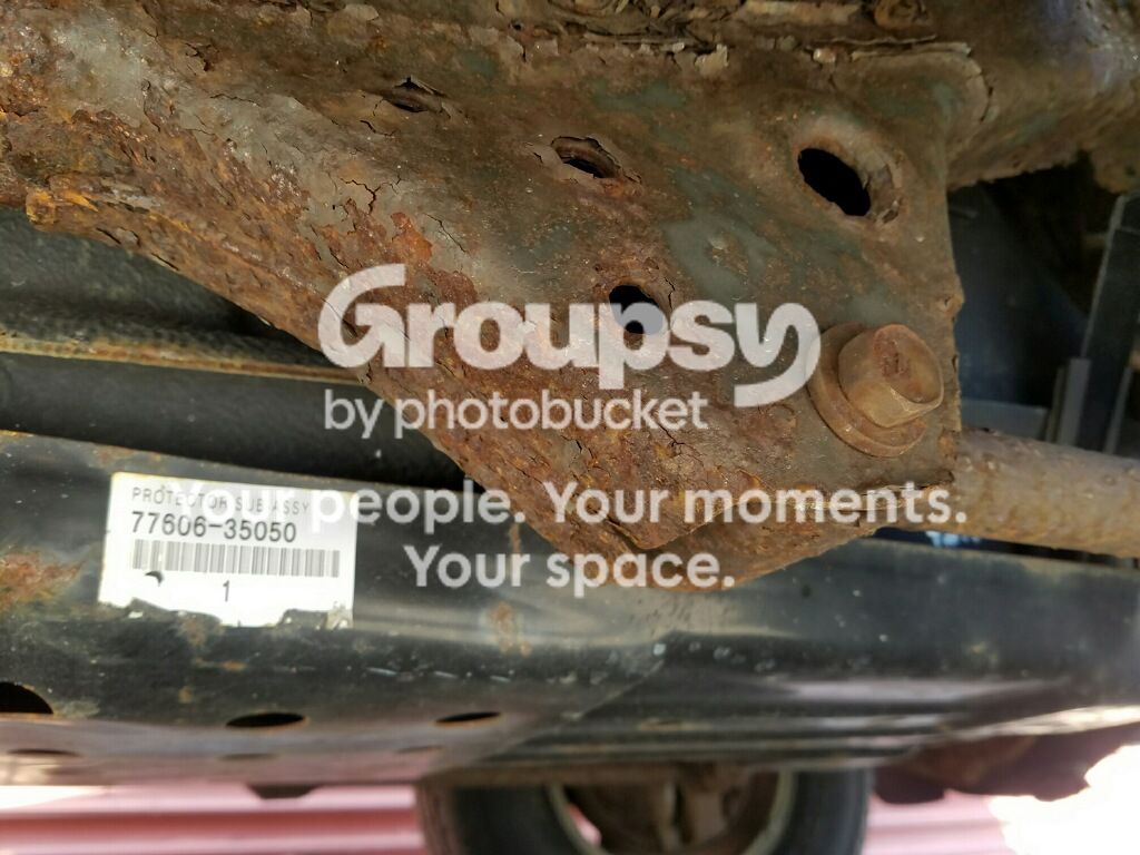

Man, even the second to last photo shows a lot of perforation in the straight parts of the frame....that is way worse than my Taco was...
Hit it with a hammer...I kid you not, that is the test. You will smash right through that thing.

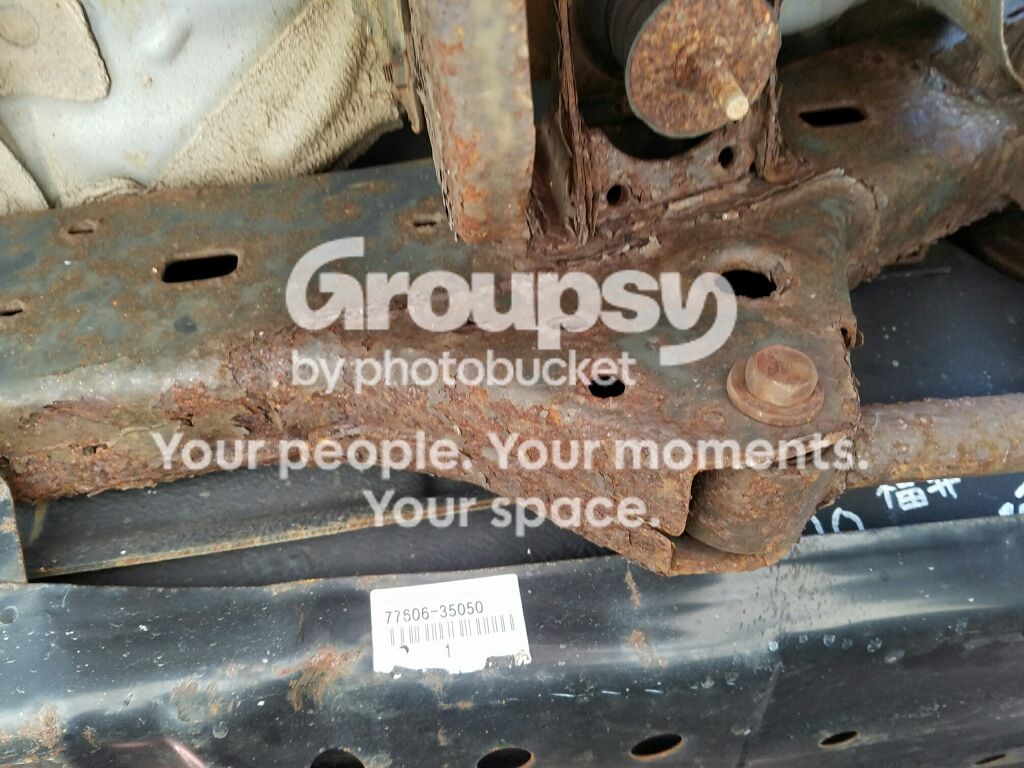

Pic 14 - control arm mount about to break off

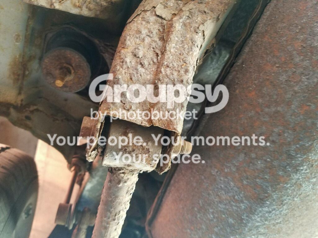

pic 17 - cab mount about to break off
Unless the price is outrageously low, this thing is A MESS.
I know I am posting a lot on this, but I can't stop myself. This is bad.
Anyone that doesn't know rust or thinks this is repairable is a lunatic or can fab up their own frame. Every bolt on this truck is going to give you problems. Try removing a shock...not going to happen. Want new calipers? Good luck. Oh, how about some LBJ's...in your dreams. Sure, you can drill out each snapped bolt, maybe you can weld on a new mount.
I called the guy up and told him I am going to pass. I appreciate you weighing in. I just HATE that such a low mileage runner is trashed due to rust. 60k miles! it was owned by a little old lady he chose to drive her Lexus verus the runner the majority of the time.
Yeah that thing is toast. I think what happened is they drove it sô little and parked it with salt underneath which just ate it away.
