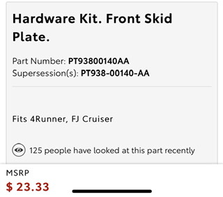

Where do I get those thin washers that hold the TRD Pro front skid plate bolts and bushings on the skid plate?
What are they called?

Push nut bolt retainer
This is the whole hardware kit.
I recently got a knock off TRD style skid off Amazon and the retainers that came with it were just thin, semi-rigid plastic. I don't know what the OEM solution is but if/when I need more I'm just gonna cut some more out of plastic. I figure pretty much any of the rigid, clear plastic from the packaging of retail goods should work.
