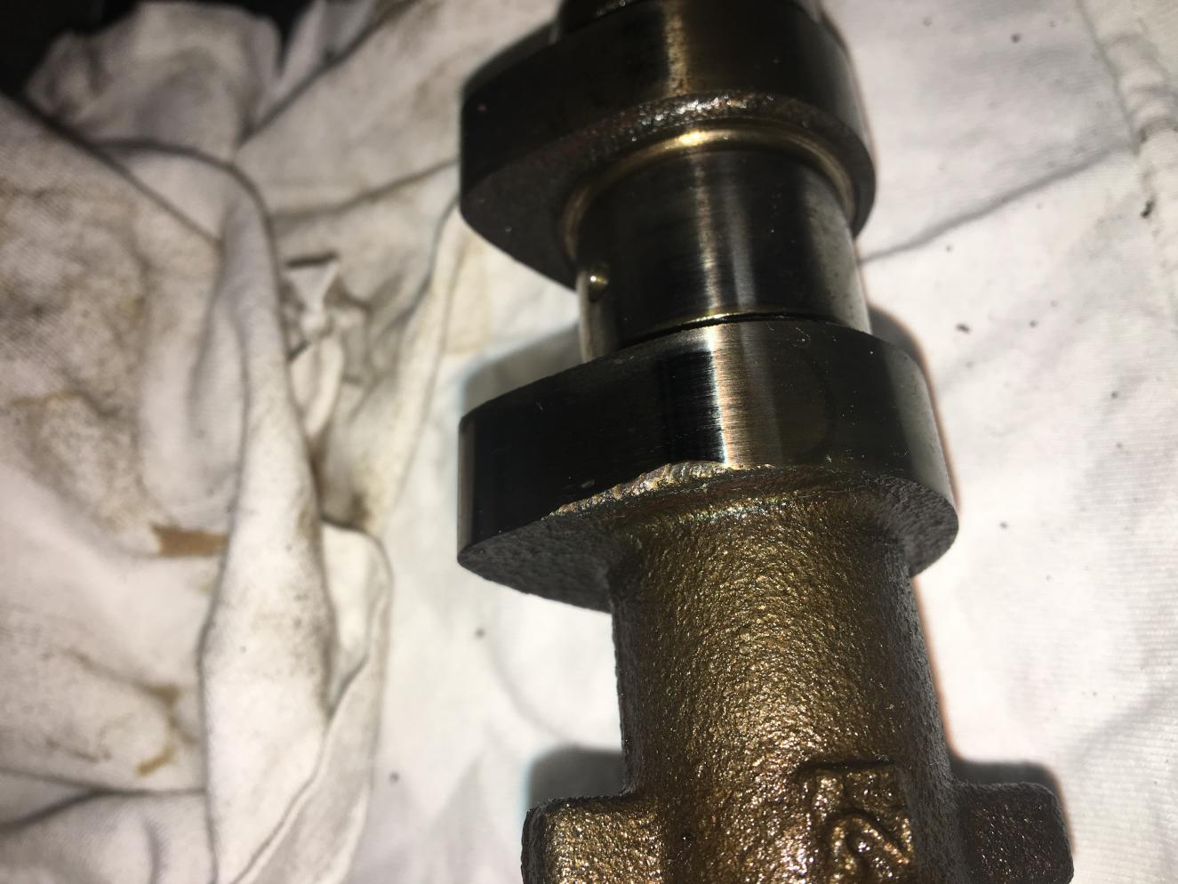

Currently rebuilding the engine on a 1999 SR5 manual 5 speed with 451K miles on it. All camshafts look pristine upon disassembly; but noticed wear on the right bank Nr. 1 cylinder rear exhaust lobe. Does not look like corrosion or damage during operation, but could be manufacturing defect when they cut the camshaft? I am going to let the machine shop offer their recommendation on replacement; but appreciate any opinions or feedback.

My old engine had a nick like that and didn't affect the shim. The most vulnerable part is the tip of the lobe, if that's worn out or cracked it can cause issues and crack more.
How did the shim that was under it look? Any uneven wear? That'll tell you more if you should replace it.
