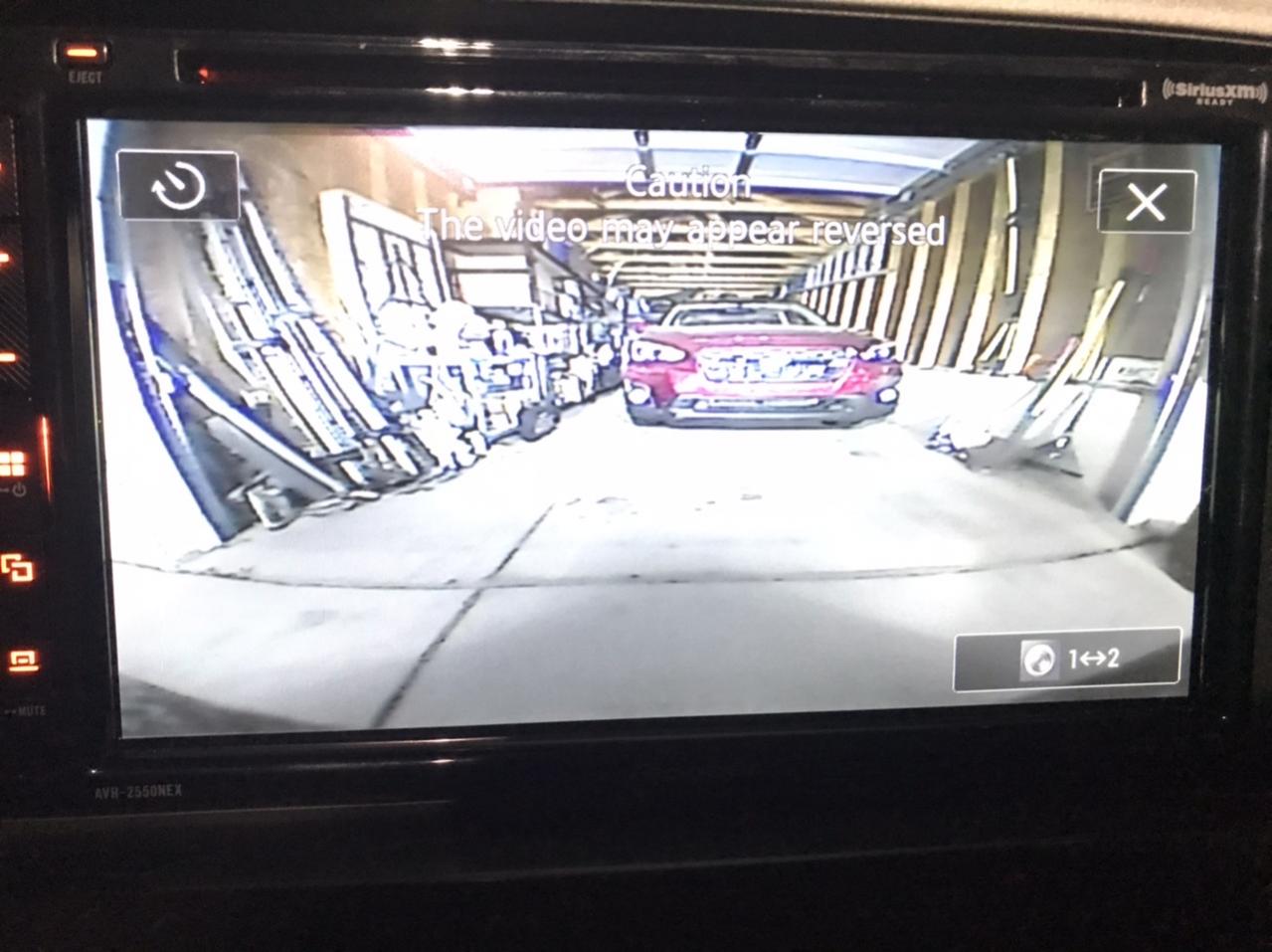

Put in a new Pioneer AVH-2550NEX head unit last week. I previously had an older Kenwood DDX-471HD (from 2014) and had installed a Pioneer Nd-Bc8 back up cam on rear with the Kenwood. I had settings to be able to reverse images on the HU as needed.

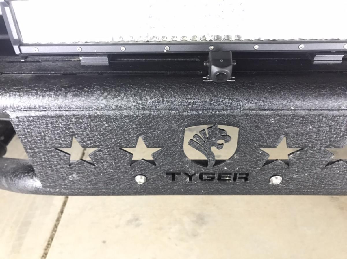

My new Pioneer was installed with existing backup camera with proper image for the back up camera. I am happy with the cam so I ordered another for the front. Put it in last night but the image is reversed left to right (mirrored). There is not a setting on the HU I’m seeing to switch nor on the camera. I called Pioneer and they said I’d have to purchase a different brand camera made for the front that doesn’t automatically mirror the images.
Is there a way to reverse the image that anyone knows about? Maybe a setting or something I’m missing? Am I able to modify the camera or wiring somehow? I’d prefer not to have to unphish all the wiring and reinstall/phish new wiring? Any suggestions or help?

Anybody???
If not, what are you guys running for a front camera where the image is not automatically mirrored? Recommendations?

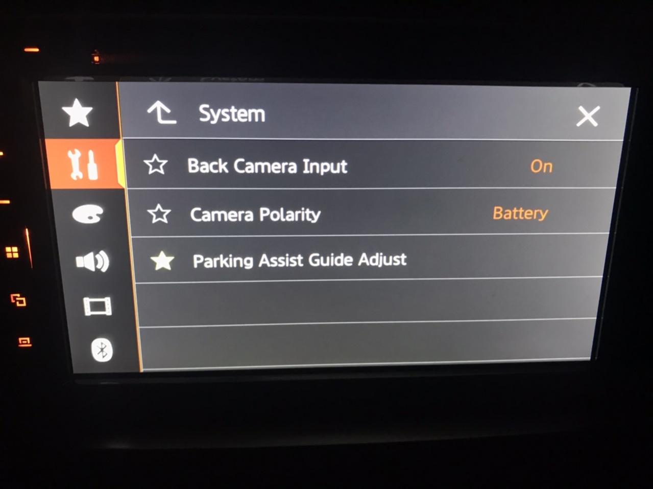

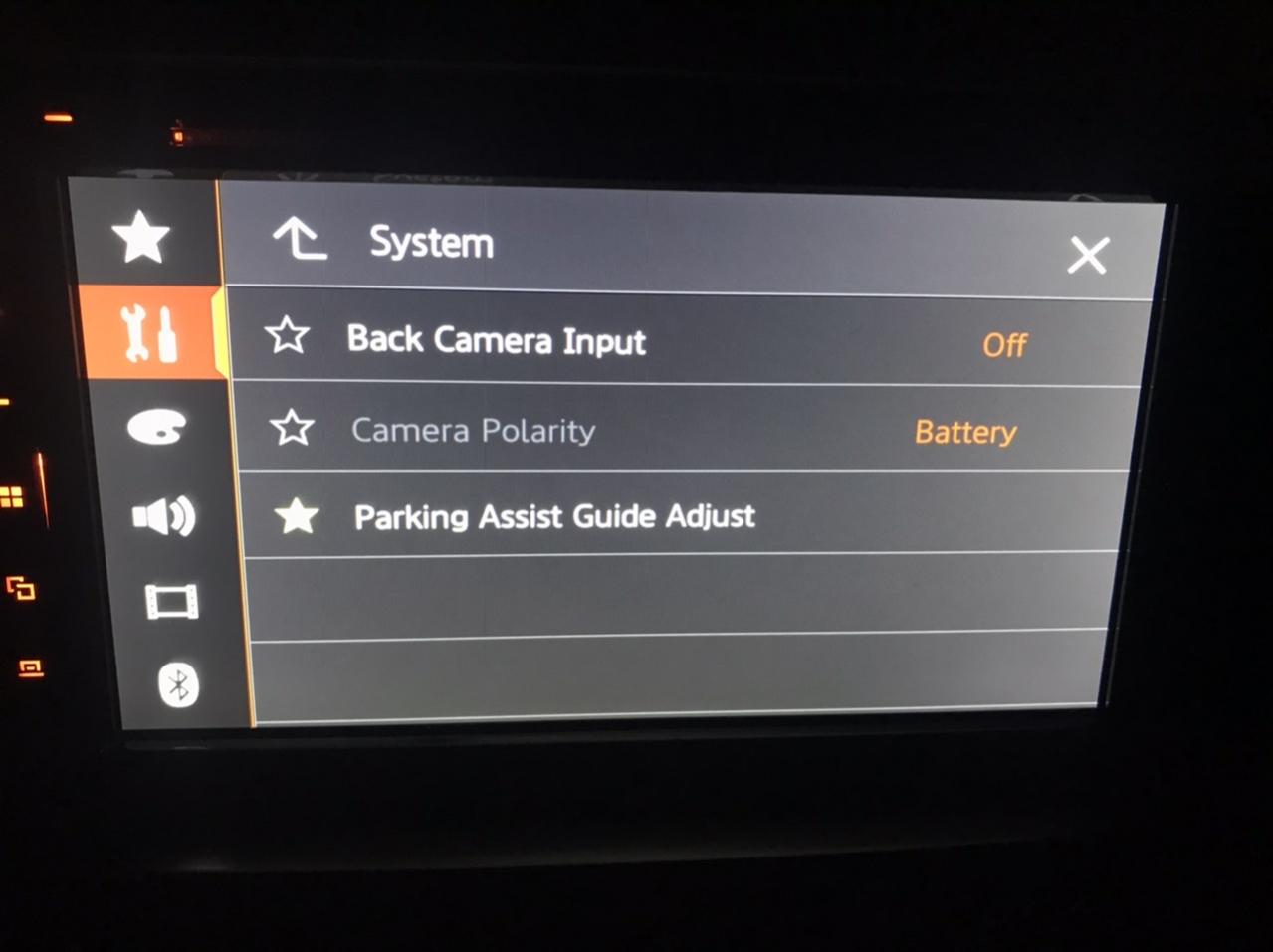

I don’t have those options available. It’s either back camera on or off. When on it triggers the reverse cam and automatically pops up on the screen, off it does nothing. I don’t have a second option for front camera really. It asks about the AV for a camera or video source (or something similar to that). Messed with this setting as well. Only thing it does is that when I’m in camera view mode for the rear view I can toggle from camera 1 to camera 2 by pushing the camera toggle button on the lower right side of screen.
I’m wondering even if it did have a “reverse image” option if it would only apply to the rear view anyways and may not work, even with my prior Kenwood?
