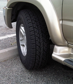

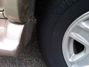

Pics of installed Geolanders-
I've been considering picking up a set of those Yokos...who did you order from and how much $$ where they?
