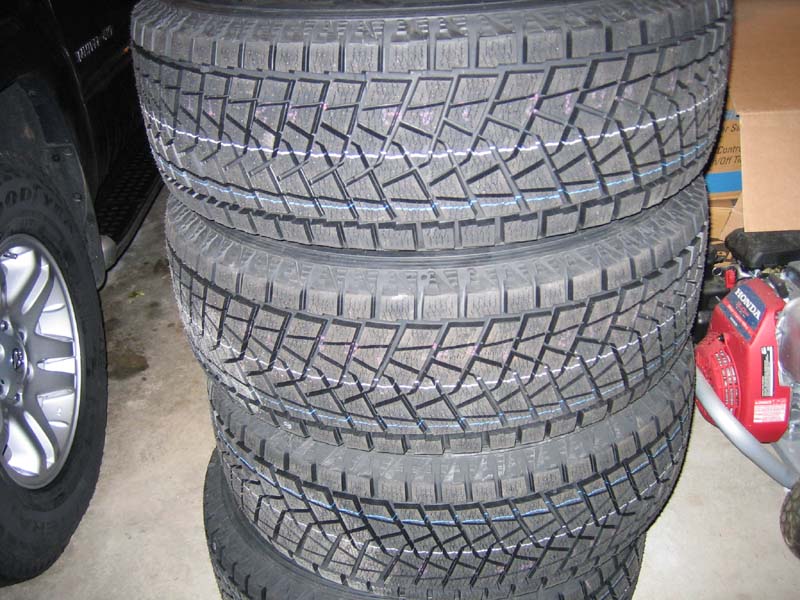

Here are the Blizzaks
Just got these Blizzaks mounted today. I'll put them on the truck when the snow hits. They are OEM size 265/65/R17.
But first, I have to try out the 4 new Goodyear Fortera Triple Treads that I had put on the new wheelset. They also have the M+S snowflake symbol, but have a very high rating for wet and dry weather handling.
The Fortera's only came in 265/70/R17 so I had to upsize the tire slightly. I noticed a very light rubbing (front wheelwell) when backing up my inclined driveway, so the fit is not perfect. This MAY have something to do with the Sequoia wheels they are mounted on.
