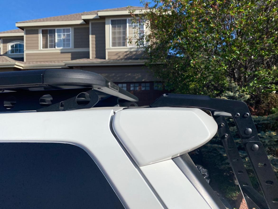

Bellow are some photos

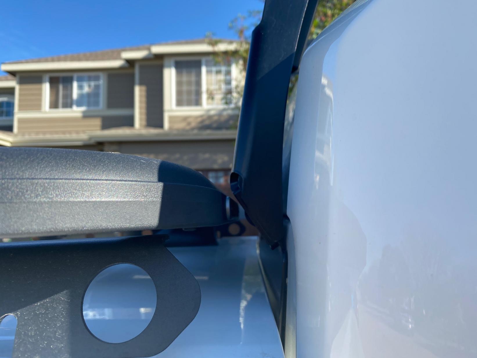

1. You can see the ladder has about 1/2 inch, with the rack giving the shark fin about 1/2 inch as well.

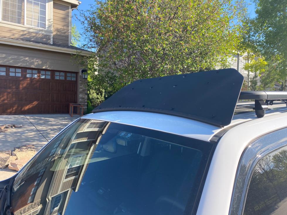

2. Fairing is laser cut aluminum with rubber molding on the bottom. The brackets are reused from the crappy Rhino fairing. You could easily have some alum ones water-jet cut. It went from no way am I driving at speed with the sunroof open to cruising at highway speeds with it open. Added bonus was 2+ mpg highway!

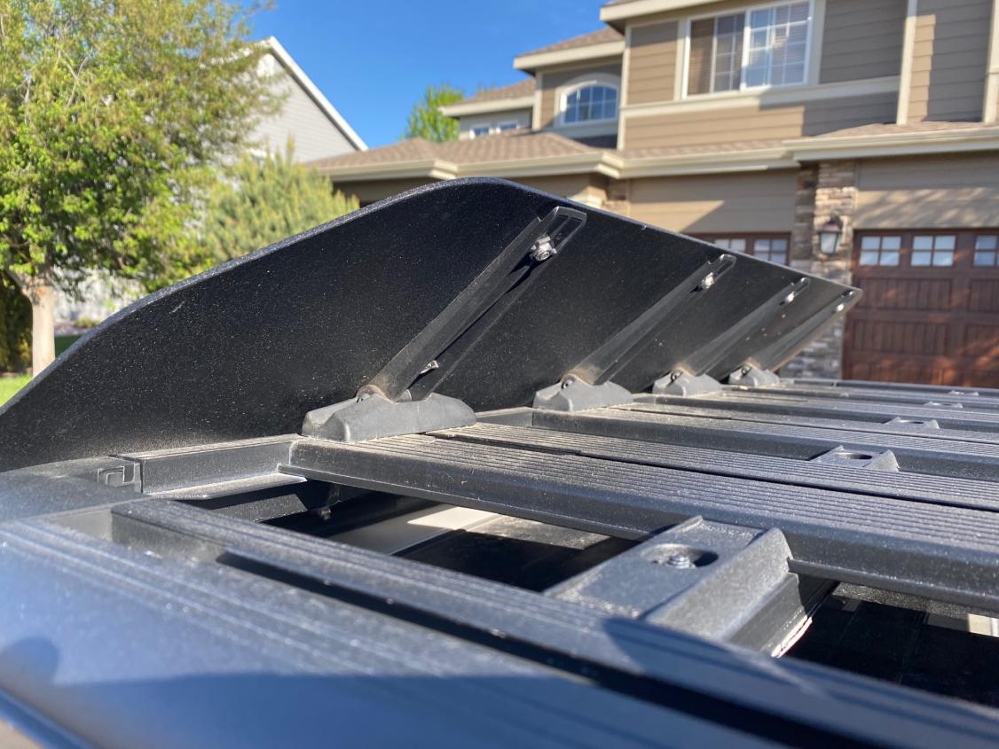

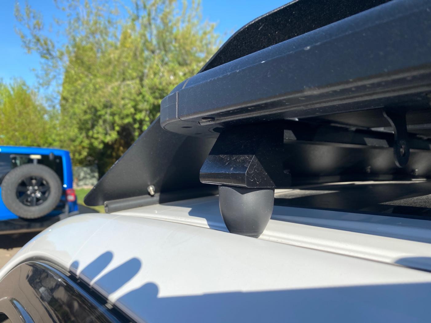

3. Third front foot, yeah it needs them. Water-jet cut alum. with rubber bumper that thread in for adjustment from McMaster Carr. In the gutter. I found there was a lot of bounce which sucked with the fairing and my fly rod carrier.
