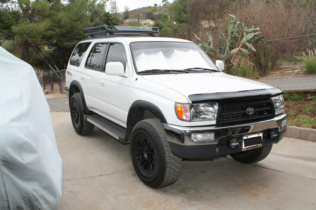

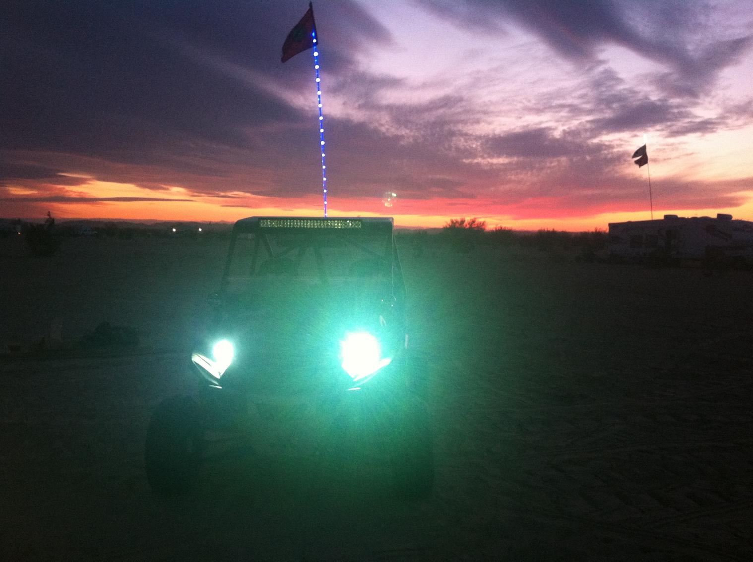

I have the rigid 30"E series light bar on my Kawasaki teryx (sxs) it is a lot of light! lights up the desert nicely to the point of confidence on night rides (dunes) .they are big $$$ but also top of the line when it comes to off road lighting.cant really go wrong with maybe a 10" bumper mount or 20" roof mount would be a great set up for the runner.mine were set up in a floods/spot /floods configuration with the outside 5"(apron) being floods on each end for side illumination .i wouldn't recommend these lights on the road use,you will look like a "ufo" coming at oncoming traffic and probably cause an accident . my runner isn't my designated off road vehicle but i love the fact that its a little bad ass and capable if need be ,so my 4runner gets a set of piaa 510 just to show some love (big soft spot for her) ,lol. i couldn't find any shots with the lights on so i posted you can see the floods on the outside
