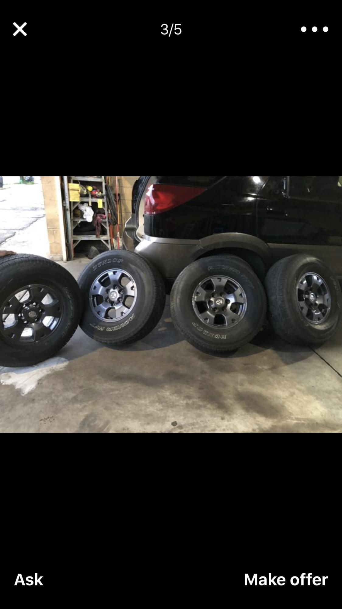

However... I think I’m going to go pick up these 265/75/16 Tacoma rims/tires. At least look at them. Good as backup for winter maybe.

Picked them up and they are pretty nice rims. The tires are ok for summer.
Now, just like a girl, my Runner has different shoes to pick from
