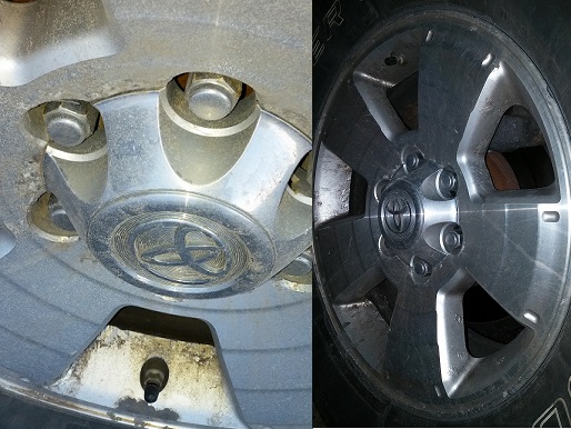

I had the same issues with both sets of stock wheels. My SR5 wheels were pitted something terrible from all the salt. I washed it often and still the salt seemed to eat right through them.
Bought some Sport wheels about 6 years later (below) and within 1 winter they started to do the same thing. Took them off and put Teflon coated American Racing ATX wheels on. They've been on for a couple winters now and I've yet to see any issues at all.
Same issues here as well. The previous owner didn't care to clean the wheels it seems. They're peeling, bubbling, rims are leaking... But at the price you were given for powdercoating, I'd find a set of used wheels on craigslist/ebay (although you run the risk of getting a bent rim...). I went that route and scored some wheels from a 2010+ 4Runner for $200

Same issue on my 07 stock wheels, i usually can get about 4 days before the tire light comes on. I was quoted $65 to sand down the bead and primer it from a local rim place, but they said that it would probably only last 5 years before it started again. He also quoted $90 per wheel to powder coat them. My issue is only two of my tires so far are leaking and i only use these wheels in the winter so i don't really want to spend the money on them.
