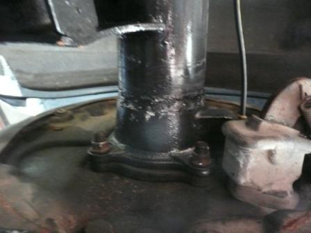

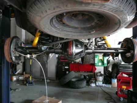

well this is the way i fixed it (tera 60) if you have had this happen to you fill free to ask me any thing i would be glad to help.
So you are saying you put in a Teraflex 60 complete? Still 4:56 gears? I'm not surprised it blows rear ends, have you had it dynoed for actual rear wheel horsepower and torque? I'll bet it's a lot more than the stock rear end was designed to take plus turning those big meats.
yes I put the teraflex 60 on it but in order to keep my abs we used the bearing pakes from my old axil and had custom shafts made becouse the sencers are there in the bearing pakes. i have not had it dynoed on a proper dyno but I had it done on an Auterra unit befor the pullys and fans and it sead 225 at the wheels but I am excited to get it done professionally. when I do I will post some pics of it .

I am not sure it would be HP or TQ related since the Toyota 8" rear end has been used behind 400-500+ HP engines without issues. Or just on the torque side of the house alone behind dual t-cases with ultra deep gears and tires in the 37-40" range. That is one of the great things of the Toyota light truck with a rear -end comparable to most 1-ton rear-ends on the market.
