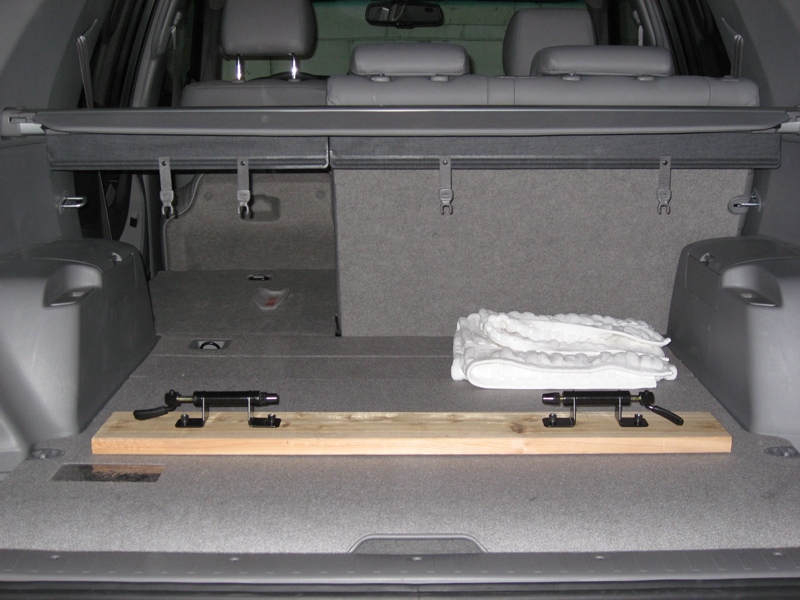

I cut a 2x4 to fit the width of the carpeted area right at the rear hatch. I bolted a couple of the fork quick-release mounts on it and stuck some velcro on the back of it to hold it down and make it easily removable -- the bike sits with the rear tire on the folded down seats. I ride a 57cm frame and it fits just fine, but I do have to take the saddle/post off.
Oh yea, it doesn't take much velcro to hold it VERY secure. I used too much and it's difficult to get it off the carpet!

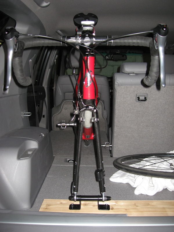

Just to follow up - I looked into the bar at princess auto but ended up going with a simpler setup.
One 1"x6" cedar deck board with rounded edges (cut to 37")
Two $16 clamps from MEC [www.mec.ca]
Velcro adhesives from Home Depot.
Holds very well under cornering and braking.
That is the exact same "cheap" one I posted about. You can spend more but not do as good. One thing I did notice is that you didn;t have to remove the seatpost. You must have more room in yours than a 2001.
