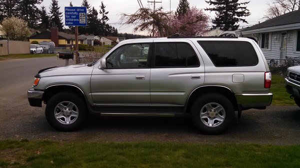

I purchased a 2002 SR5 with ~179K on the clock March 01, 2015 for $7K. Overall, it was pretty clean, not perfect, but frame was solid and not rusted, no noticeable leaks and drove well. I had been driving a 1994 Toyota extended cab V6 4WD manual DX since 2002. So this felt like a huge upgrade for me in terms of power, luxury, and ride smoothness. I had caught T4R fever from surfing this forum too much. I already had designs for what I wanted to do when I bought it.
It took me a while to find something that I liked that was in good shape. Everything out here on market in the PNW is usually either beat to hell, or very expensive. I really wanted something that I could safely transport my drums with. I could have bought a canopy for my pickup, but I also liked the idea of having more seats for when family comes to visit. A canopy would not fix that issue.
Pics upon purchase: 03-01-15

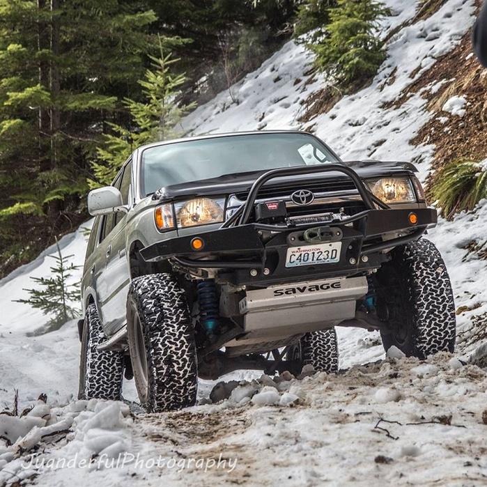

2002 Toyota 4Runner SR5 4WD
Engine / Transmission:
-Stock 5VZ-FE 3.4L V6
-B&M 70264 Transmission Super-cooler.
-4.88 Gears (added 09-10-18)
-Rear ARB Air Locker (added 09-10-18)
Wheels / Tires:
-ProComp 7069 Series, 16x8, 4" BS removed
-SCS F5 16x8" 3.5 BS in Matte Gunmetal
-Cooper STT Pros 315/75/16 E-rated
Suspension Front:
-King 2.5 Coilovers w/ 600# springs (about 23" H to F)
-MStudt's Sway bar extension links (standard type)
-Sonoran Steel Front Differential Drop Spacers
-SPC Light Racing Upper Control Arms (on G) setting
Suspension Rear:
-Sonoran Steel 1.2 Rear Lift
(2)-Toyota 80 Series Land Cruiser Coils (7 wraps) >>Removed<<
(2) ARB / OME 861 Coils w/original isolation cones >>Added<< (~25")
(2)-Genuine Toyota Tokico Black Rear Shocks & Supporting Hardware
(1)-Sonoran Steel Adjustable Trac/PanHard Bar
(2)-Sonoran Steel Extended Bump Stop Adapters with
(2)-Daystar "Competition Style" Bump Stops
(2)-Sonoran Steel. Rear Sway Bar Adjustment Brackets
(1)-Sonoran Steel Braided Stainless Steel Extended Brake Line
(1)-Sonoran Steel Parking/Emergency Brake Bracket
(2)-Sonoran Steel Rear 4Runner Polyurethane Body Mounts (for stabilizing the rear bumper)
Armor:
-Addicted Offroad front plate bumper
-Stubbs Welding HD-SKO rock sliders
-Savage Off-Road full skids
-4X Innovations Rear bumper with tire carrier (added 07-31-17)
-Lotus Rear Trailing Arm Mount Skids
Recovery Gear / Offroad Upgrades:
-Warn M8000 with Master Pull 5/16th Superline
-Factor 55 1.5" Hawse Fairlead
-Factor 55 Flatlink Expert shackle
-ARB Twin Air Compressor
Lighting :
PIAA 510 Crystal Plasma Ion Yellow 4" (waiting to be installed)
Brakes:
-13WL 231mm Tundra Brake Upgrade
-Toyota OEM Tundra Rotors
-Toyota OEM Tundra Pads & Shim Kit
-NAPA Remanufactured Calipers
(Front)
-Wheeler's Off-Road braided performance brake lines for TBU upgrade (SKU: TF BLINE-06X)
(Rear)

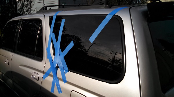

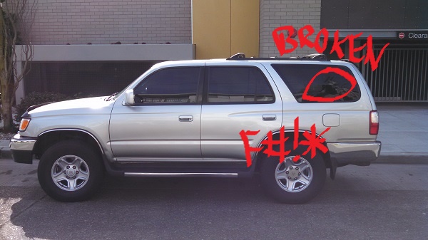

The day I was scheduled to go get the windows tinted, a rock, or something, busted out my left rear window. Major bummer. I had the rig for a week and was adding insurance THAT day. Technically I was still covered for up to two weeks, but I knew this would not be ideal.
Window drama... First place I was recommended to by my mechanic was a nightmare. They used non OEM glass. The gasket that comes with the window was less than an ideal fit. I had to pay out of pocket to get things rolling until my insurance caught up with me in the system. Once the job was complete I noticed about five 10+ inch scratches on the outside of the window. Manager insisted the glass was new... I had some words. I had them remove the glass and refund money. I had somewhere else install OEM glass and they did a FAR better job. One pic, hard to see, but was the growing hole in my rear window, then the better of the two fixes.
The fronts were tinted 15%. I dig it.
Yes!!! I got the window replaced between rain storms. And in this part of the country, that is saying a lot!

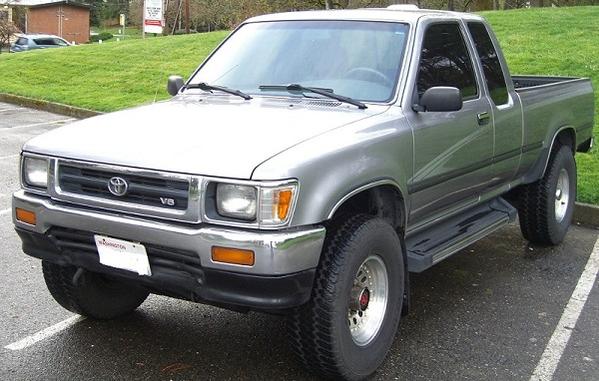

the only thing I like more than 3rd gen 4runner is a clean 90's toyo pickup. had a 93 pickup with 250,000 and was amazing. nice rigs!!
I agree. I love all the contours and curves of that design. It's weird, but the door on the truck seems far more substantial compared to the 4runner. Not sure why that is. That truck has been very good to me. Great size for a truck too.

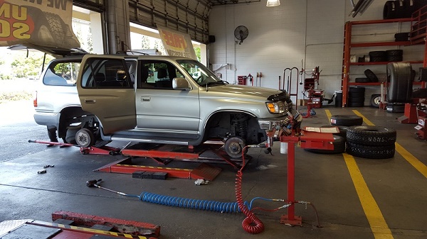

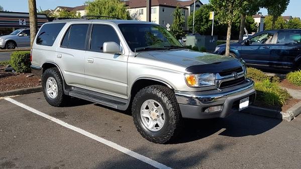

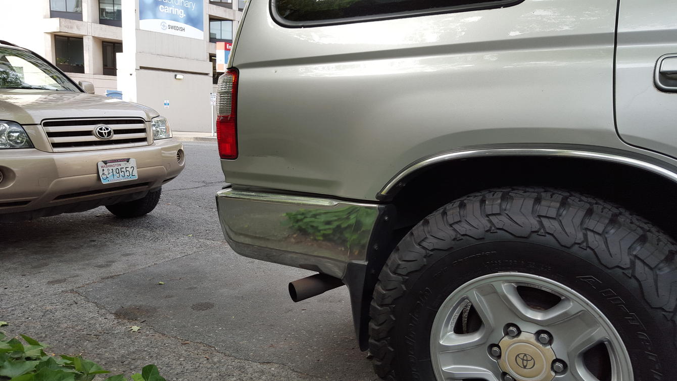

NTD!! New Tires Day.
Yesterday I picked up some tires at Discount Tire and got the lifetime alignment at Firestone.
BF Goodrich KO2s 265/75/16.
So far, no rubbing on stock suspension. I have not had a chance to put it in the dirt yet though. I have only had a chance to do some highway driving and some around town pavement driving. They are pretty quiet. I think BFG did a great job there, and I like the new look. I had talked to a lot of people that had been using the new KO2s and had asked a lot of questions. They had used them in rain, snow, dirt, mud, and so on and gave very positive reviews. Now... its my turn.:banana:
I am looking into a mild lift. I think I decided that I don't want the standard 3" lift. I am looking into a 99-tall suspension lift, or maybe 2" lift. No body lift.
I have not had a chance to see how much of a hit my mileage has taken going from 265/70/16 Michelin LX to 265/75/16 KO2s , but I don't think it will be too much. I wonder how much my speedometer is of now? lol..:suspicious:

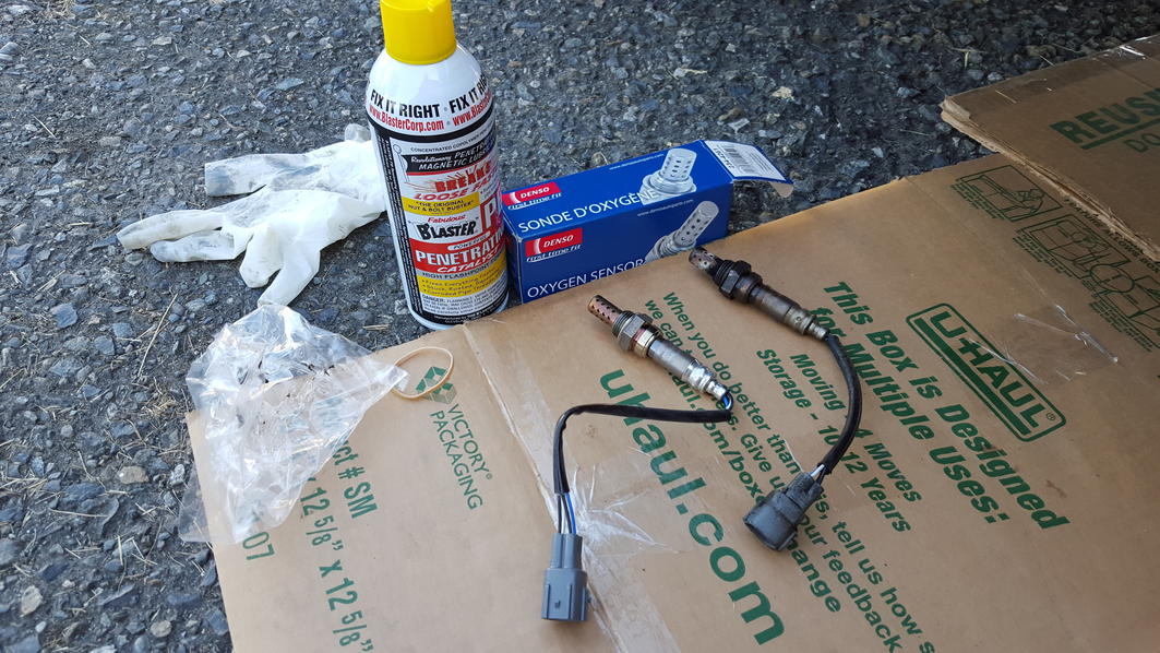

Ha! O2 sensor conquered! I had to up the ante in my bitter fight with a stubborn bolt locking the sensor in place. I initially hit it a couple times with WD-40. But I think jumping to the big guns with PB Blaster gave me the edge I needed to make that damned bolt budge. I will give it a bit, but I am hoping this kills my P0420 CEL issues. Fingers crossed.
Kind of early to say, but it looks like my CEL, along with the VSC, VSC/TRAC lights are finally taking a rest after being on for about a month or so now. Since replacing my O2 sensor, I have driven ~60 miles today. I filled up, and when I turned the engine on, the CEL did not come back on! WOOT! Hopefully they stay off for a while. I hate annoying dash light driving distractions. If this holds up I will be very happy.

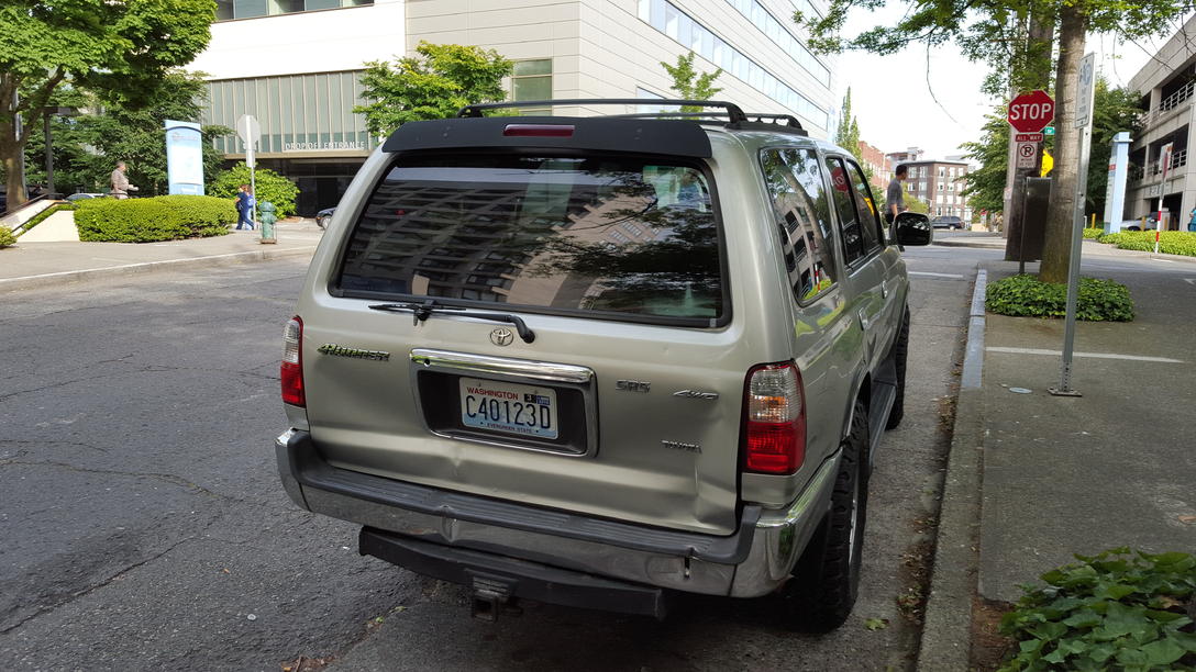

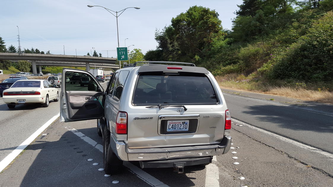

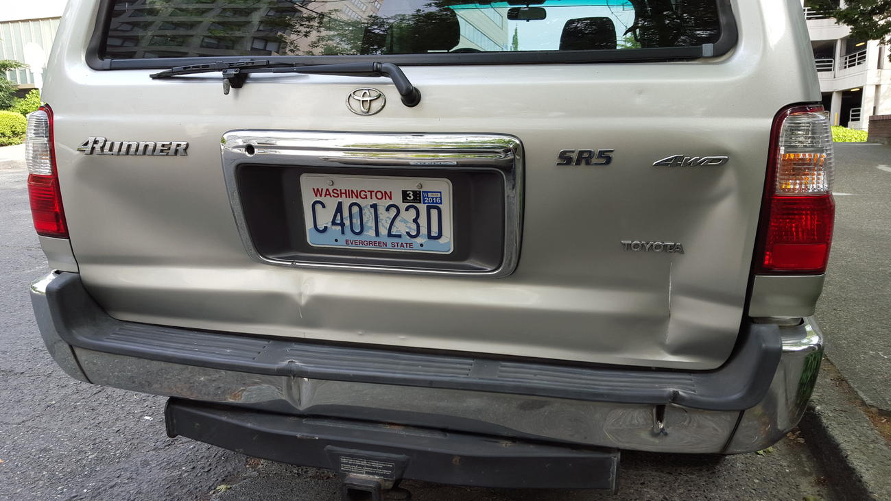

So... I got rearended today in stop and go traffic on I-5. I was stopped, had been stopped when some Jackwagon in a Nissan Pathfinder with a bull bar hit me. He wasn't going too fast, thank god. But both myself and my passenger have the usual post accident funk. I feel badly for my passenger. She just got a cortisone shot into her neck this morning for all her neck pain. What are you gonna do...
My rear hatch looks like its toast. Bumper is also toast and has a hole in it. Man... I am super glad both of us are OK, but bummed that I just cleared my CEL by replacing my O2 sensor this weekend to be knocked down a few pegs.
