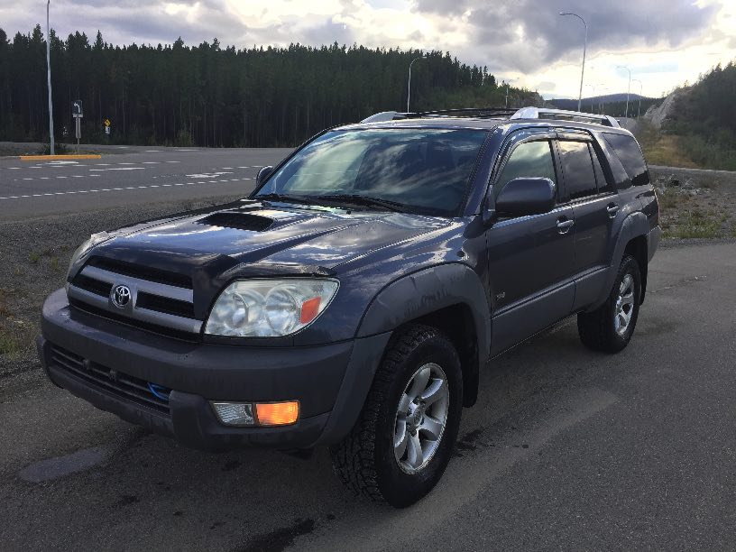

So... I've known for many years that I can be a sucker for punishment.
Because I'm a sucker for punishment, I saw a 4th gen come up for sale locally for a suspiciously low price, I ended up jumping on it. I guess because I wanted a project?
The point of this thread is to chronicle the rebuild of a tired, used old 4th gen. I didn't do it with my 3rd gen but this truck will also be much more in-depth when it comes to work needed. I'm going to smash my head against the wall some days, but it's okay.
It will be a daily driver, but I have a nice 3rd gen as well as a pickup and motorcycle to use if need be. If the truck is down for a week or more it's not the end of the world. Initially I plan on getting the truck back in to a safe condition that I can daily and take my 3rd gen down for some much-deserved maintenance. As for build ideas, I rarely find myself in mud holes, but do climb the odd mountain and take the (much) less travelled road to visit a placer miner friend or two.
Here's the basic stats:
Born: February, 2003
Purchased: August 23, 2018
Mileage: 319,700km
Price: $2500 CAD
Trim: SR5 V6 / Sport

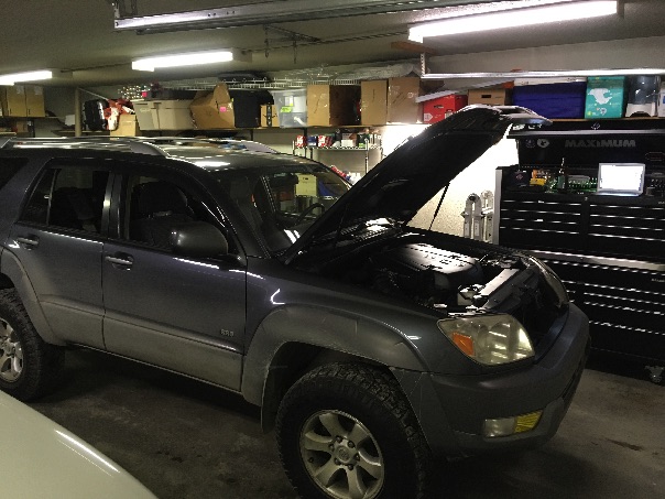

Catching up over the past week.
The truck currently lives in my garage. Good for it, because that's where nice things go (like the contents of our house. We moved about 3 months ago to a house which also needs a ton of work (think nearly a gutter and you're almost there).
I brought it to the shop and threw it up in the air to get a good idea of what I'm looking at for work.
Needs brakes desperately. Like, "don't drive this thing" bad. It's got 13WH calipers so that is a small bonus. Also, it's super clean underneath.
Spoke to my local friendly Toyota parts guy. The local dealer wanted nearly $800 per corner for reman calipers so I noped out of there and on to the ol' Rock and my friends at NAPA.
Hood & Hatch struts, pads, upper & lower control arms (which I likely don't need), sway bar links for front and rear from RockAuto.
Rotors and calipers from my local NAPA. With the pricing I get there and the freight for shipping chunks of steel to the Yukon, it made more sense to do it this way. I'll only replace calipers if need be, but I've got my suspicions.
I have not ordered suspension yet but am leaning toward Eibach Pro-Truck from Wheelers.
Today, I had 4 boxes of parts! Yay! So, I started taking stuff apart. As a little present to the truck, I also bought a set of late 4th Gen LED tails and a new set of headlights (that I'll build a retrofit in to this winter).
Tonight I installed the new hood struts - the hood actually stays open now! I discovered that when they replaced the battery this spring they decided to use a bungee cord to hold it down. I wonder what happened to the actual hold-down? Just another part to order I suppose.
I also installed the LED rear tails. I wasn't going to, but they're so easy and right there I figured why not!
I need to pick up a battery hold-down bracket, and some new hood trim clips. I noticed I'm missing a bunch down there.

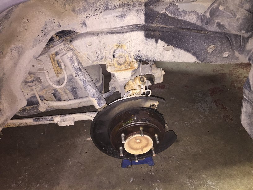

Pulled the rear wheels off and there's good news and bad news.
Good news: Rear pads actually had about 50% material left on them. They were Raybestos so it's neither here nor there. Akibono's going on next. Rotors look decent as well, and both calipers still move freely. I had one frozen pin on the RH caliper.
Bad news: I've got XREAS. From my quick reading, it appears to be a purely mechanical system, so the removal will be a bit of a PITA but otherwise a non-issue.
Left axle seal is kaput as well. Looks like a very similar setup to the 3rd gens so hopefully it won't be a hassle. Will have to get my seal puller and drivers from the shop tomorrow before I can get it all done.

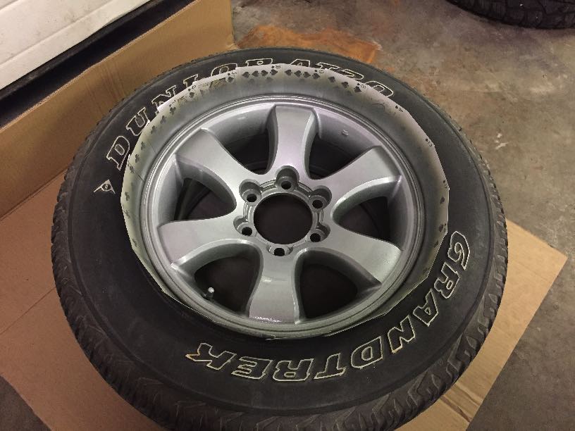

I also picked up some gear to try my hand at cleaning up the rims. I took the spare and gave it it scuff, prime and a couple of shots of paint just to see what is happening.
I might refine the process a bit as it looks like I picked up some dust and debris while things were drying. Overall a fairly simple process. If I choose to do the other 4 wheels it will be while I have tires and valve stems out.

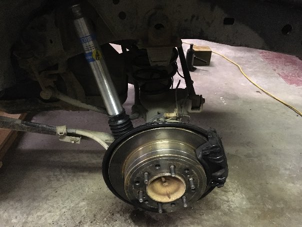

So... I got to do some work on the '03 to get it mobile again.
I wasn't looking forward to replacing an axle seal based on my negative 3rd gen experience. Turns out Toyota learned a bit and put the seal closer to the flange. Hardest part of that was dealing with the parking brake line.
I replaced the rear rotors and pads. I was planning on doing calipers as well as they have a habit of freezing up and I had bought some NAPA remans. Turns out that I got 2 rights. Talk about frustrating. Thankfully the left rear wasn't frozen so I re-used it. On the reman, it's a poor quality product. I wouldn't use it again if not for the price... I had to clean up the flange for the banjo bolt as it was folded over during reman and I couldn't bolt down the brake line. Cue panic while I have a slowly dripping brake line (was moving past my clamp up the line) and I'm madly cleaning up the flange!
Got it put back together and out of the garage around 2:00 on Saturday morning.

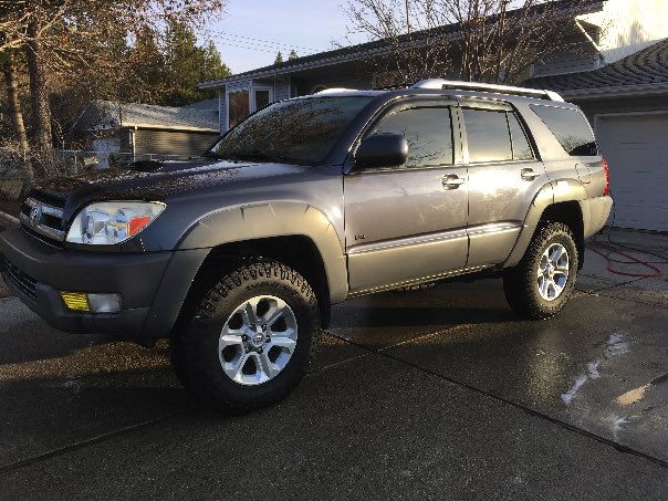

Long time no update! Between work, two kids under 5, winter and renovating a house, we've had a lot going on. This truck serves as a bit of a creative outlet because it gives me a chance to go out to the garage and decompress.
The good: The truck now has a nickname, brought to us by my partner. She has dubbed it the "TrashRunner". So, the TrashRunner has been put back together and as of Sunday, is now the DD.
Catching up...
Rear end:
Installed a Daystar spacer lift with new Delco springs and 5100's. It was original, and with 320,000Km it was shot.
Replaced one rear axle seal, rear pads (Akibono), rotors (NAPA) and one reman rear caliper.
Front End:
Replaced the struts with some Monroe QuickStrut kits and Daystar spacers. Ball joints and tie rods were surprisingly tight. I ended up having to take the struts and springs apart to bust out the top hats as they had made themselves one with the rest of the truck. Brute force and ignorance!
Pads and rotors were done as well as both calipers as they were frozen. Replaced both CV's with NAPA lifetimes. CV angles appear to be decent so I'm not overly concerned with boots tearing right now.
I also pulled off the skid plates and cleaned them up, degreased and repainted with rocker guard.
I had some 255/75 Duratracs installed earlier this winter and put everything together.

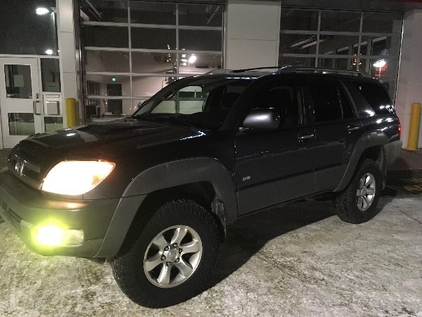

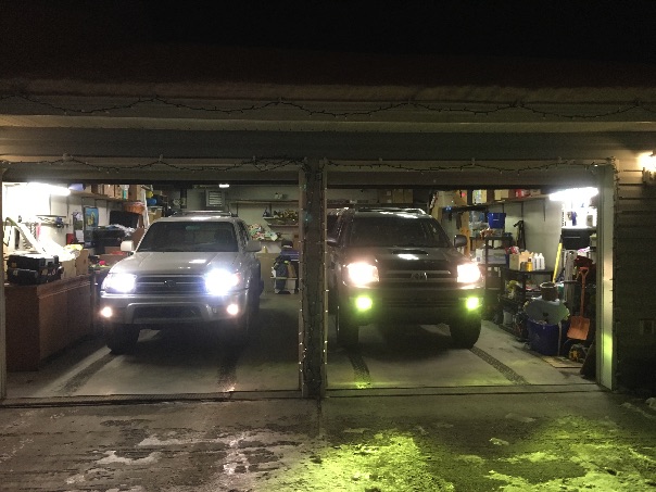

Another nice side project was that I installed a set of Morimoto 2Stroke LED bulbs in the driving light housings and did a yellow Lamin-X install on the lenses.
Got things put together around 1:30 on Saturday morning and went out for a bit of a rip!
So far, not bad.
The bad: I still need to do sway bar links and bushings as I have something rattling around in the front end. It's still stuck in 4WD but at least the centre diff is unlocked.
On Sunday I tore the interior apart and shampooed the carpets (ew!) as well as the seats. It's impressive how well they cleaned up. Gave the interior a full detail which made me happy.
I've noticed that on a cold start there's a less than 1-second rattle... suspicion is timing chain slop. As I don't want to dig 10 hours in to the front end of this engine, I think I'll give the tensioner a shot. Maybe. Tonight I did a quick oil change with M1 and an OEM D3 filter because I don't know the last time it had an oil change!
Windshield needs to be replaced, I have at least one blown speaker and I have a set of TYC headlights that I'll build a budget retrofit in to...
The more I drive the 4th gen, the more I like it! I like the extra space and the extra power! However, I've noticed that it lacks a bit of the "bank vault" build that my 3rd gen has.

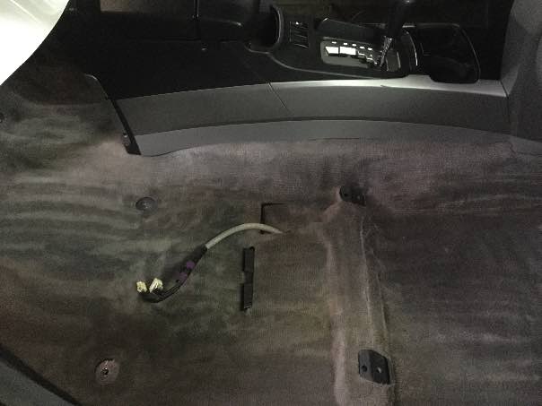

I forgot, I also made a donation to my local Toyota dealer and bought an OEM right front ABS harness as I had damaged the original when doing my suspension on that corner. The donation was $200. Parts guy did not appreciate my quip about how that was almost 10% of what I bought the truck for!
Looks like a solid daily! Hows the light output on the LED/Lamin-X combo in the driving lights? I put some Nokya yellow bulbs in mine and it doesn't have quite the output I had hoped.
The Morimoto 2Stroke is a pretty decent bulb. I've been dealing with TRS since Matt was working in a garage in Ohio so I'm pretty confident in their products.
I don't find that the Lamin-X cuts much output from the lights and they certainly overpower the stock halogen headlights. They claim 2400 lumens at 5700K temperature. I would say they're maybe 75-80% of the output of my D2S retrofit in my 3rd gen which makes sense, as they claim 3500lm at 4500k.
TL;DR - Yes, they have good output with the yellow Lamin-X. Grab your hair drier and do it up!
