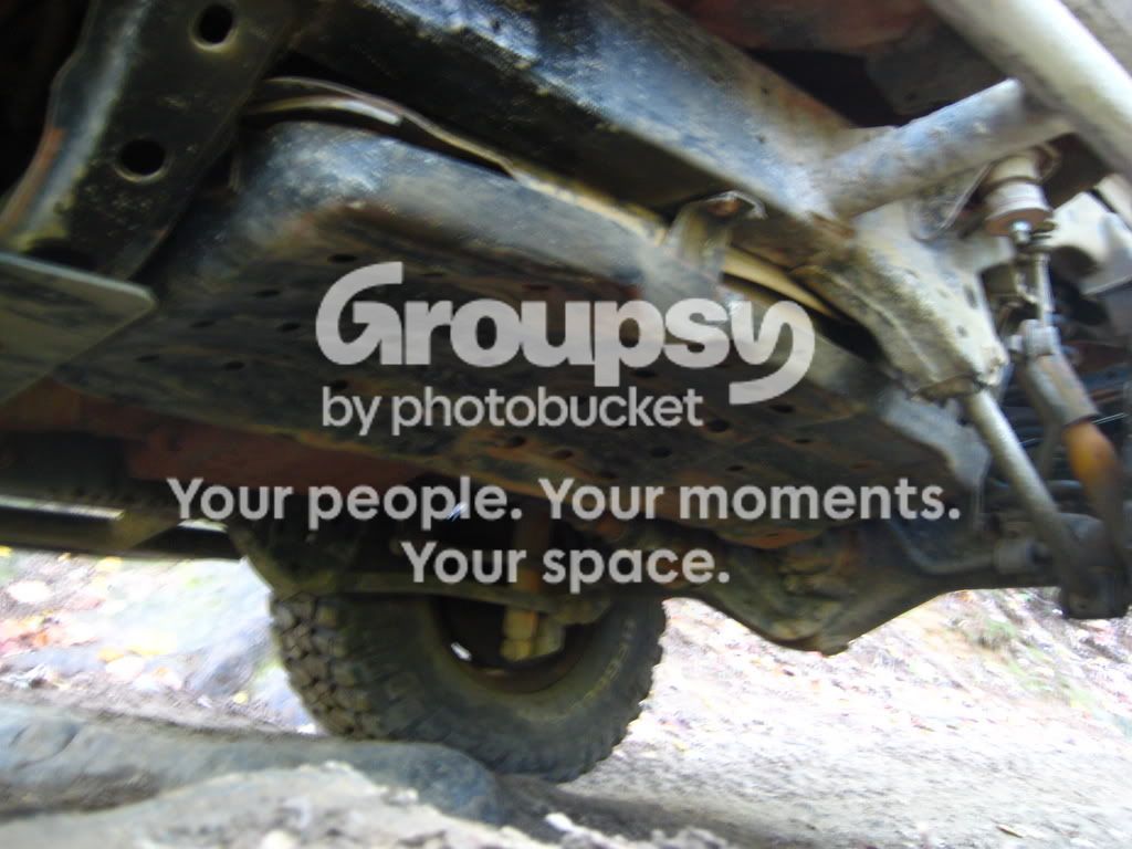

Sliders first for sure. Factory skids will do some of the job (very little, but better than nothing) but protecting the body is important. I would much rather have a dent in my gas tank than a huge dent in my door of my DD. Totally agree with others above about LCAs and mounts, you definitely want to beef those areas up. Other armor on my 3rd gen that proved to be useful where lower shock mount skids and e-locker actuator skid (not sure if that applies to you, but if it does that is very much worth protecting). Below is my factory gas tank skid after running lower 2 at tellico (RIP). Like I said above, they will do some of the job, but the last thing you want on a DD is for the side of your truck to look like that.
EDIT: This is actually a great example of why I got new LCAs, LCA skids, actuator skid and obviously a new gas tank skid.

Sliders are the best to first. And those links skids sure work nice! especially for free.
As for that gas tank skid I welded some 1/4" plate strips to the stock one once it bent up and hit the tank. It has held up great now
