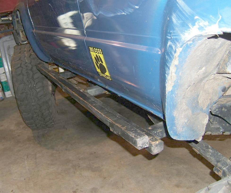

I forgot whether you're married or not, but the space between the slider itself and the nerf tube (used as a step) can catch woman's high heels. I had to modify my sliders because of this (see pics). You can do my modification on any other sliders, but ARB has it already.
I would recommend ARB, Shrockwork, or Hanna.

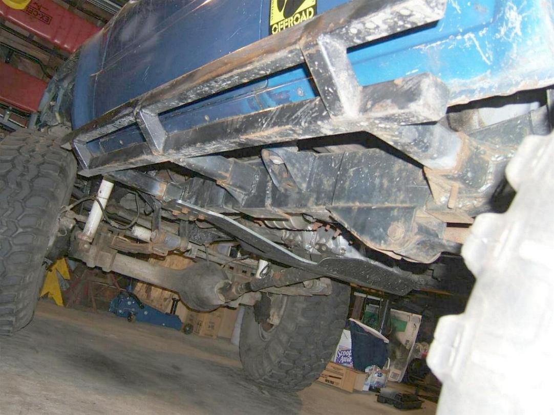

After adding a plate to cover up the space:

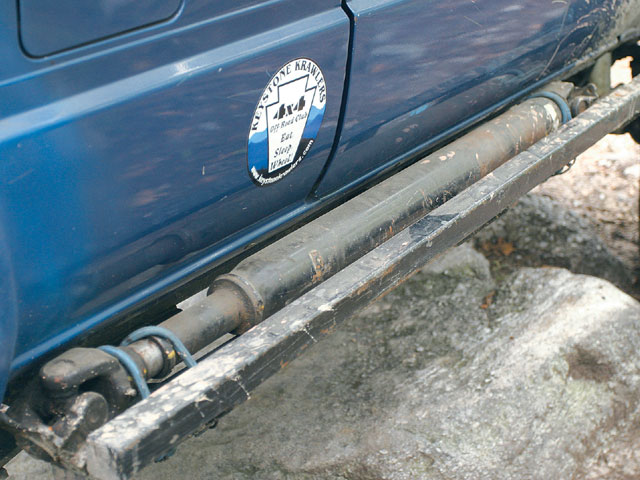

also makes a handy place to store the spare rear drive shaft (you do carry one, don't you)

Well when you wheel in the rocks you gotta be ready for breakage. I also carry a complete set of axle shafts for the front axle, as well as tools and other stuff. :D
Such an off-road geek!!:p
