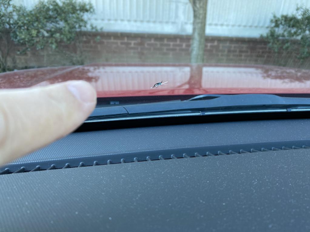

Not even a year old I got a star on my windshield yesterday. Shit. I was driving east on I80, in the second lane from the divider near Hackensak and I saw the rock come flying from the other side. It was big enough to see and I tried to avoid it but it was coming too fast.

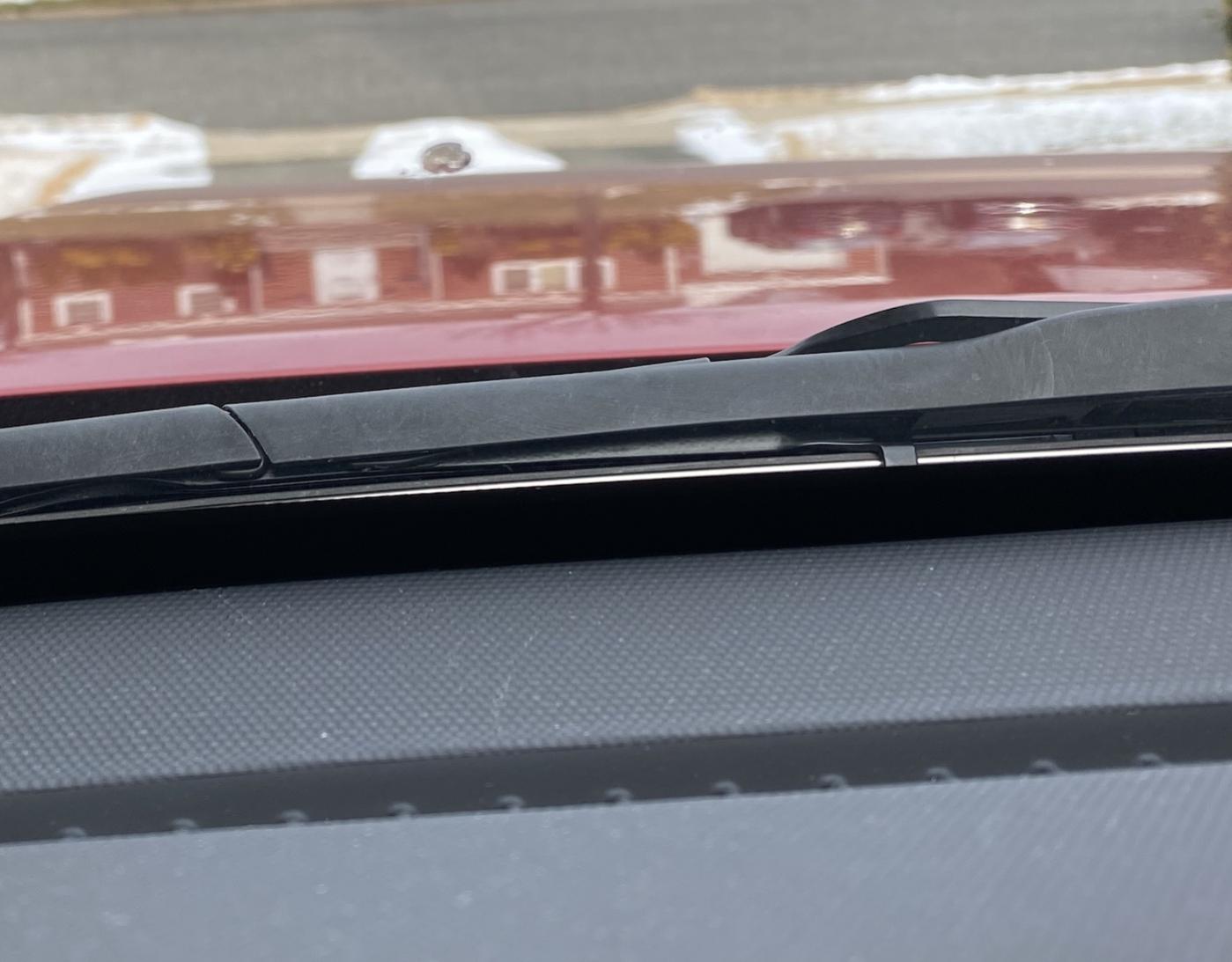

About 2 hours after chip happened I had it filled at Safelite in Pinebrook. I didnt want to wait and have it fill up with water, freeze and become a large crack. State Farm has a negotiated price with them of $95.
They had to clean out the hole to fill it and that left a spot about the size of a BB.

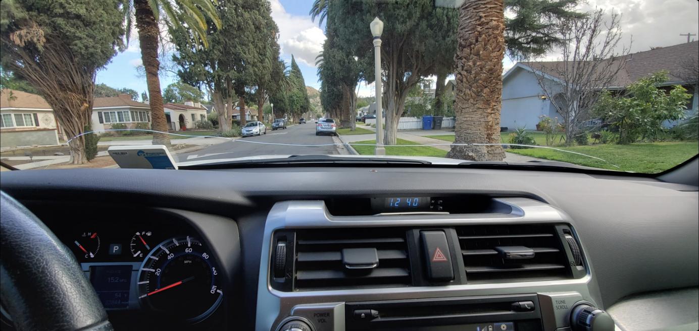

I had 2 chips, both repaired, in my windshield. While in the mountains driving slowly through the snow, with my defrosters all on, I heard a CRACK and noticed this, the crack ran through both chips. I suspect it may have been thermal stress.

In the past, I had a small star on a previous car facing east outside on a below freezing morning. As soon as the sun hit it, it cracked all the way across. Thermal stress is a good bet.
