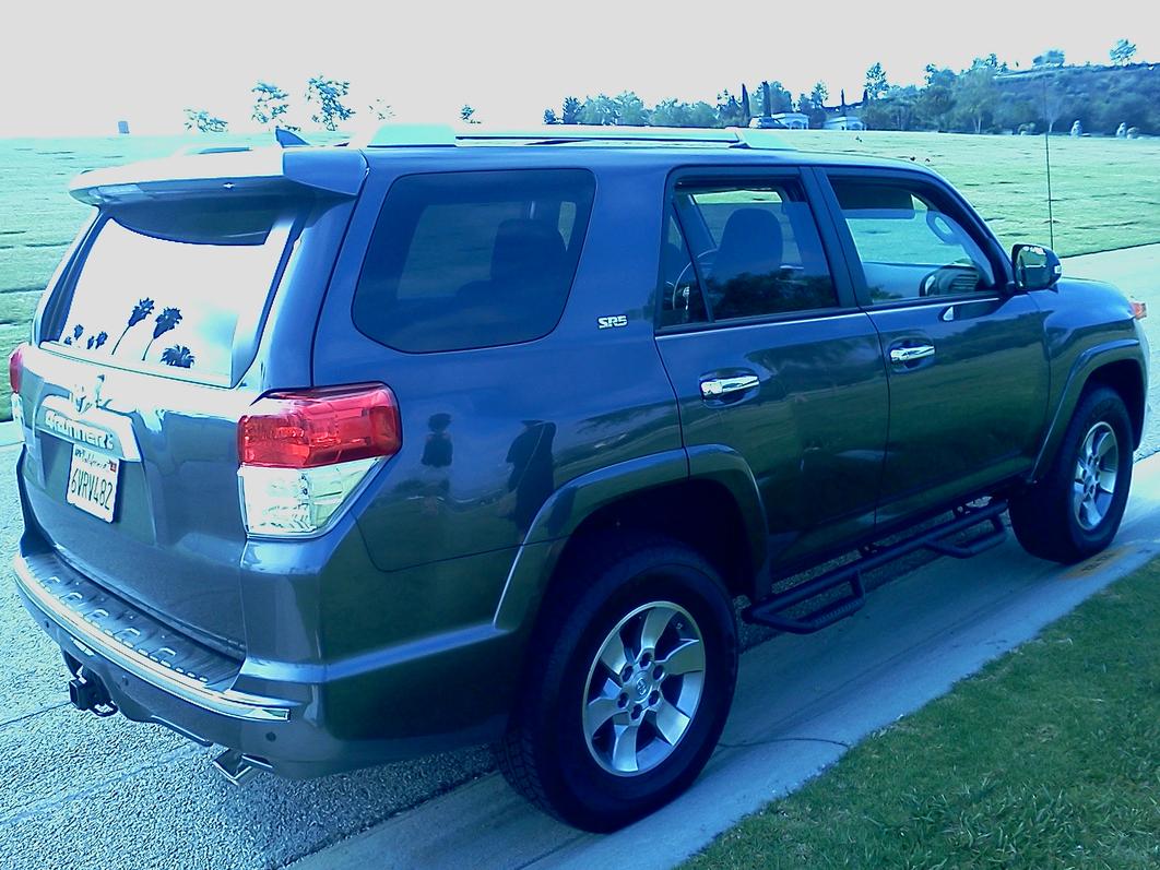

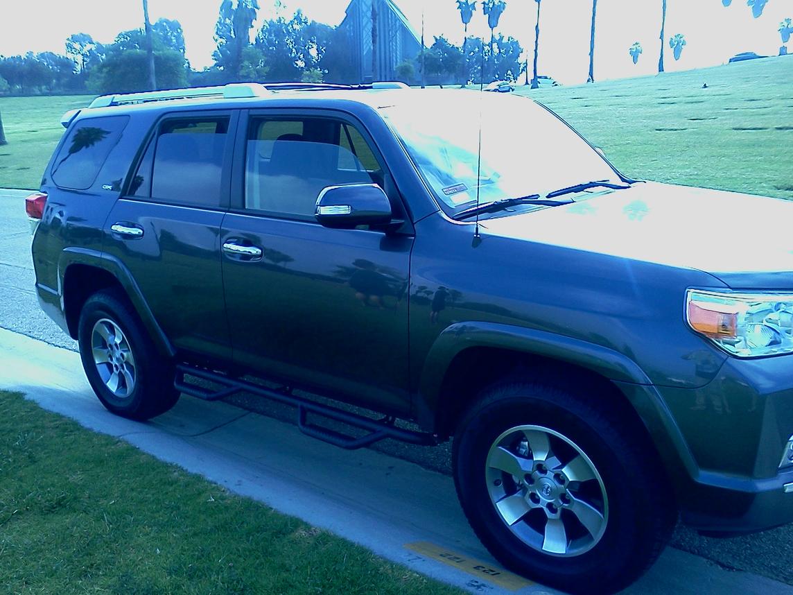

ive attached two pics of the 4runner without the rocker, but unfortunately i dont have any with the cut rocker at the moment
i will say that with it cut it looks much more finished
