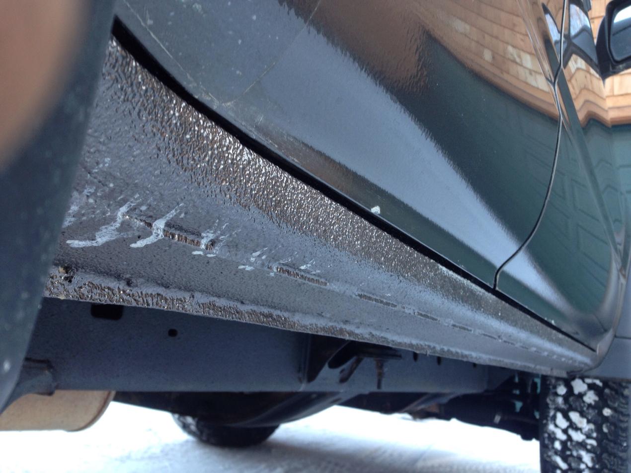

I have also used raptor liner and paint it to match. I have done this to multipal trucks. UV light or pealing has not been a problem.
I have kept one for myself. It is white and has only been on the truck for about a year. I picked this up from a buddy of mine who owns a body shop. I fix and sell many vehicles a year, no complaints yet. It has been about Four years on my Buddy's Chevy that I see on a regular basis and no problems there.
A side note I use DuPont automotive paint. As long as the paint prep work is clean so that the pant sticks the greatest determination of uv resistance is going to be the paint and not so much the base material as long as they are compatible.
