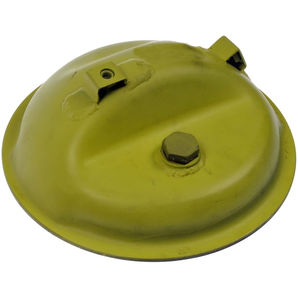

I had a pinhole in my diff cover that was able to be welded closed but I have seen covers worse than mine. If you have ongoing rust projects maybe pick up a cheap welder if you don't have one yet and tackle that Dorman replacement. If my patch & rust converter/paint don't stop future leaks I will need to cut mine off as well.

Rock Auto has these Dorman brand weld on differential covers for about $45, but with shipping it comes to $57. I found one on eBay for $45 with free shipping. I ordered and it should be here sometime next week.
My plan is to take the axle out of the vehicle to de-rust the rest of the housing and get some black epoxy primer on it. And if I am going to be spraying that stuff I should probably spray some wheels like these...
