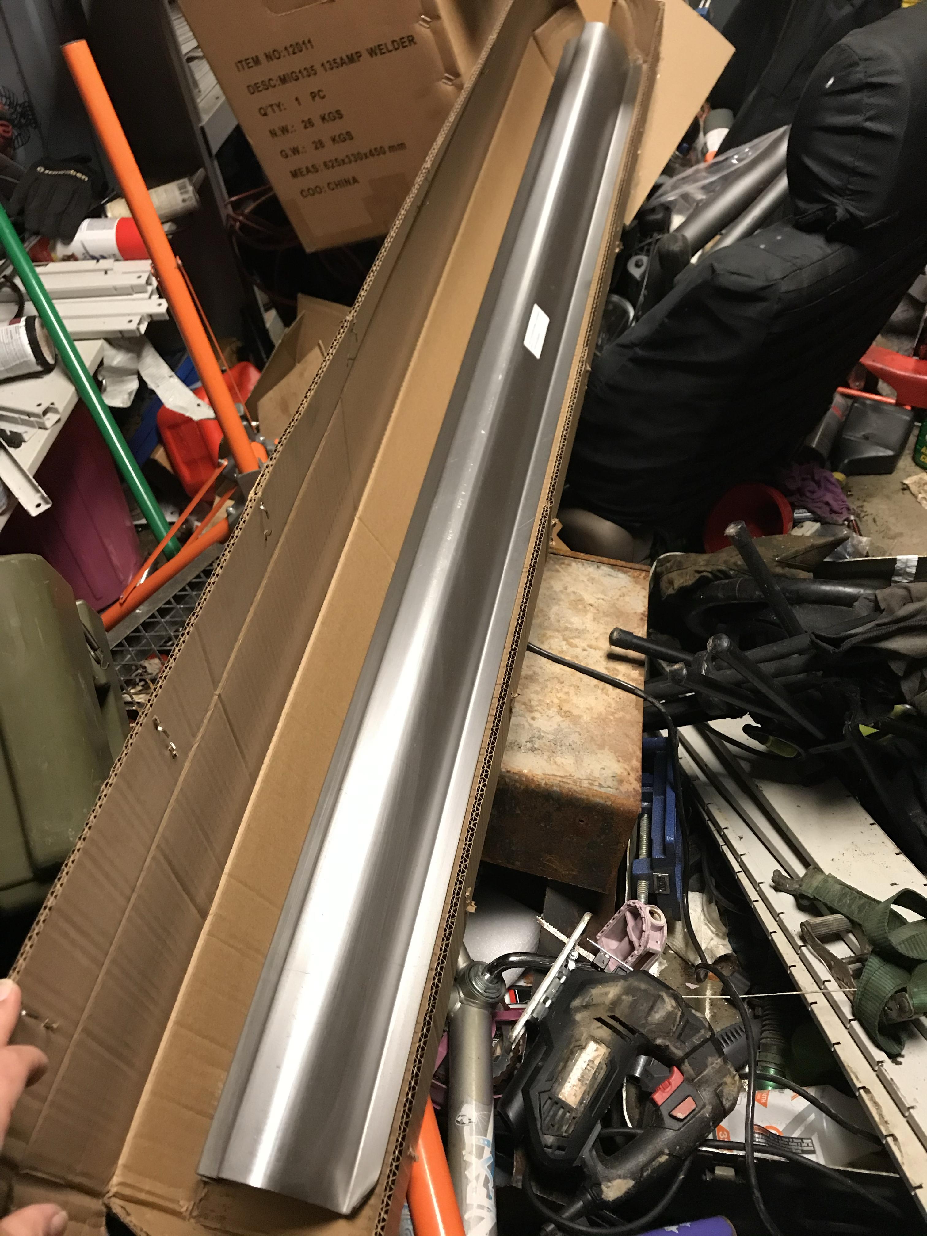

Wolf-Steel in Canada makes replacement rockers.
Do you have any pix of these installed?
Not yet.
I can’t get time to work on my sheit.
Work is crazy right now.
About to put in for a vaca so I can get everything I need to done. [emoji23]
Not yet.
BUMP
Any updates on install?! I just got some too but read they had to be modified a lot.
