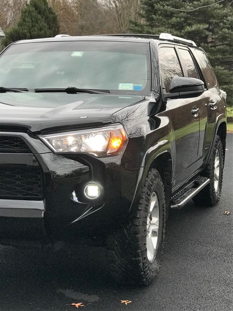

Here are my Shrockworks Step-Sliders I installed this past weekend. Love them as Steps & door ding protection... oh, and the occasional log I may have to slide over :reddance:

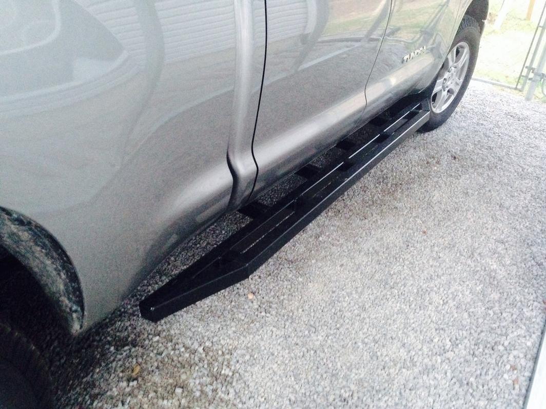

This is probably a good pic to illustrate what he was talking about. They can certainly still be used as a step, but with the upward angle of the bumpout parts they're simply not that much lower than lifting your leg all the way into the vehicle.
