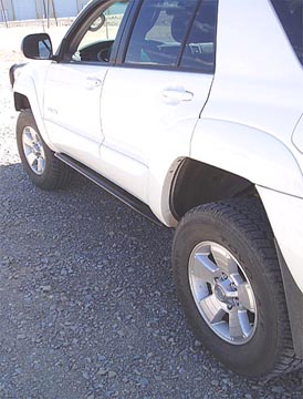

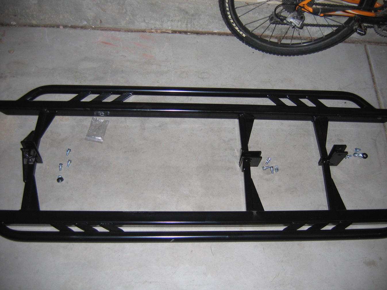

Rocky Road Outfitters Supersliders
5thgen_4runner_superslider4_med.jpg​

They use trailer hitch steel. Lifetime guarantee they won't bend flex or dent. He says he will replace them if they do. To me these sliders look great. I might look into these when I buy my sliders.
Those look really clean! I'd like to know how much they weigh, sorry in advance if it's already been mentioned...

I had a set of these on my 95 Pickup. The are very heavy and very strong. They not only bolt to the frame, they also bolt to the pinch weld/ body seam. I had a little trouble installing them, as you have to drill so many holes. The problem was not drilling, but if you are off a tab bit on one, all of them can be off, especially with the pinch weld.
After the install, I really liked them. They were solid. Just be patient and take your time.

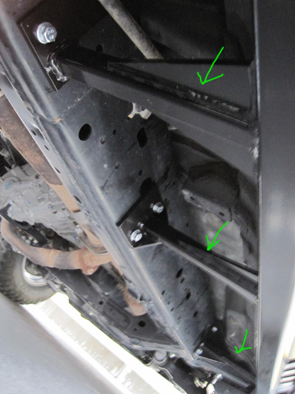

From looking at this picture, the bars that connect the slider to the frame are like 1" square tubing, which makes me think these are for steps or for
looks, not actual offroad use. No way those are supporting the weight of the vehicle. Maybe I'm missing something?
Also, those flat bar supports that tie in the round tubing to the square tubing are not confidence inspiring. Flat bar just doesn't have the same structural strength that round or square tubing has.

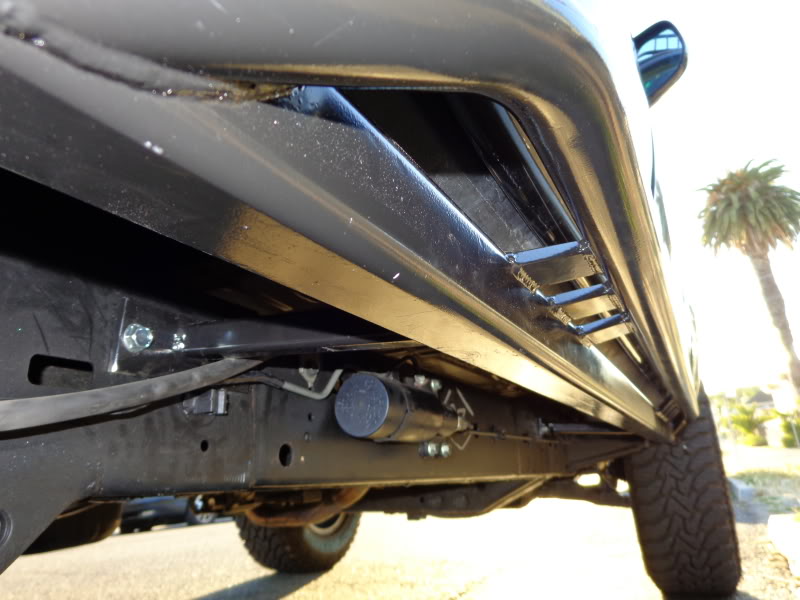

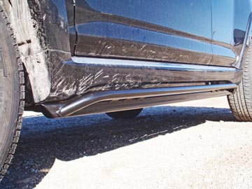

Found this picture perhaps this helps.
